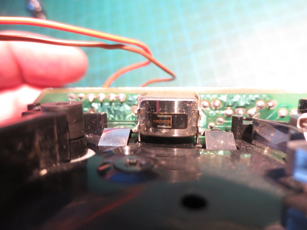

Hi forum ,
i am currently repairing a spectrum microdrive , and would like to know if the head is still usable .
Posts: 2816
Re: a bit off topic , microdrive head question
Yes.
Scuffing and corrosion not on the line taken by the tape doesn’t matter. Very light corrosion or scratches in the tape path can be polished out with jeweller’s rouge on a lint free cloth wrapped around a small dowel.
