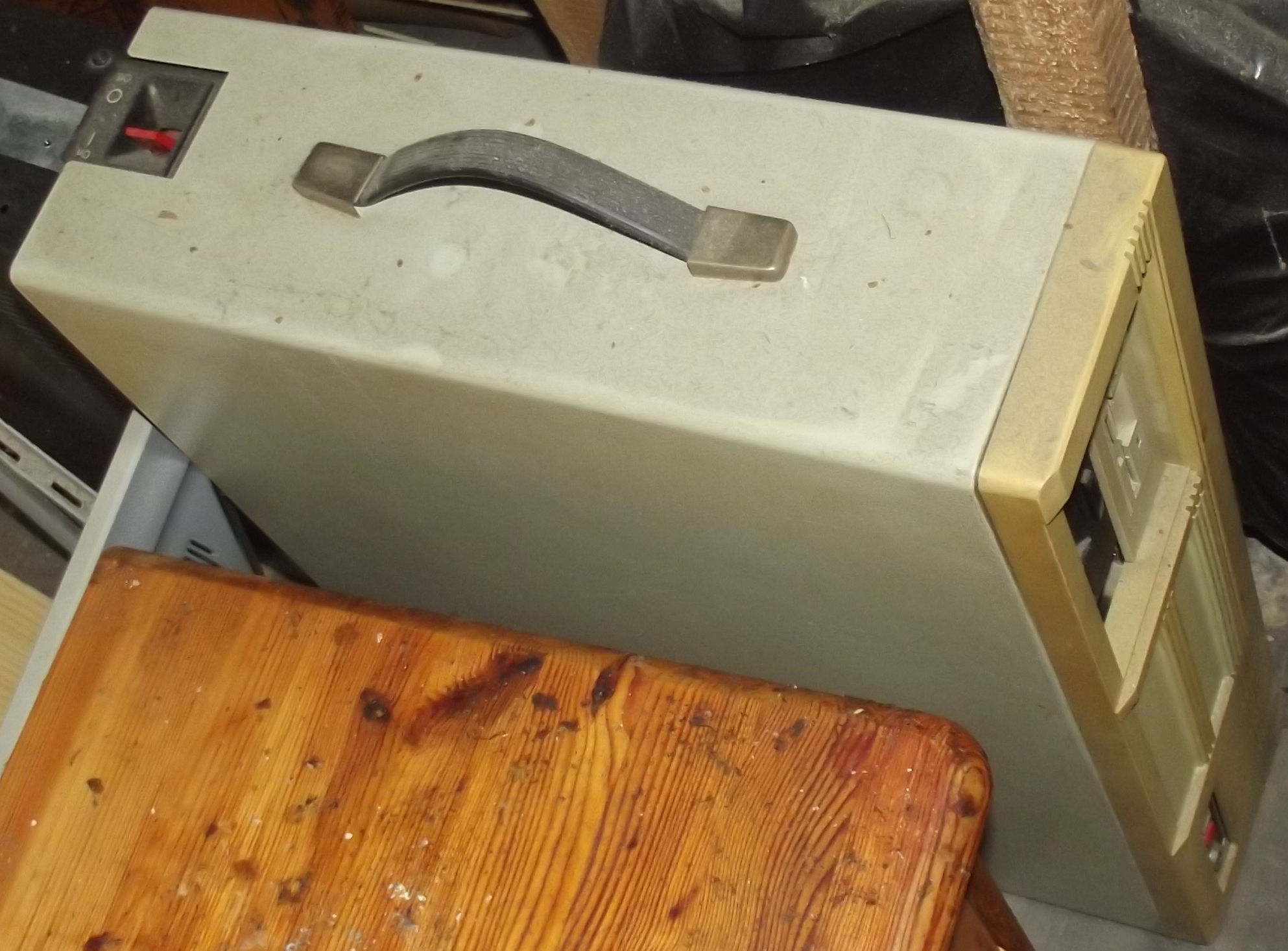

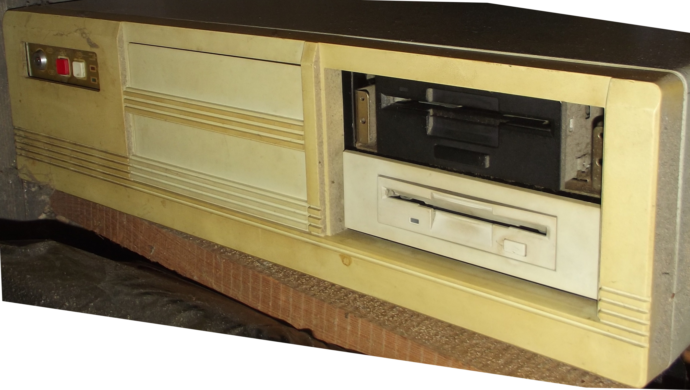

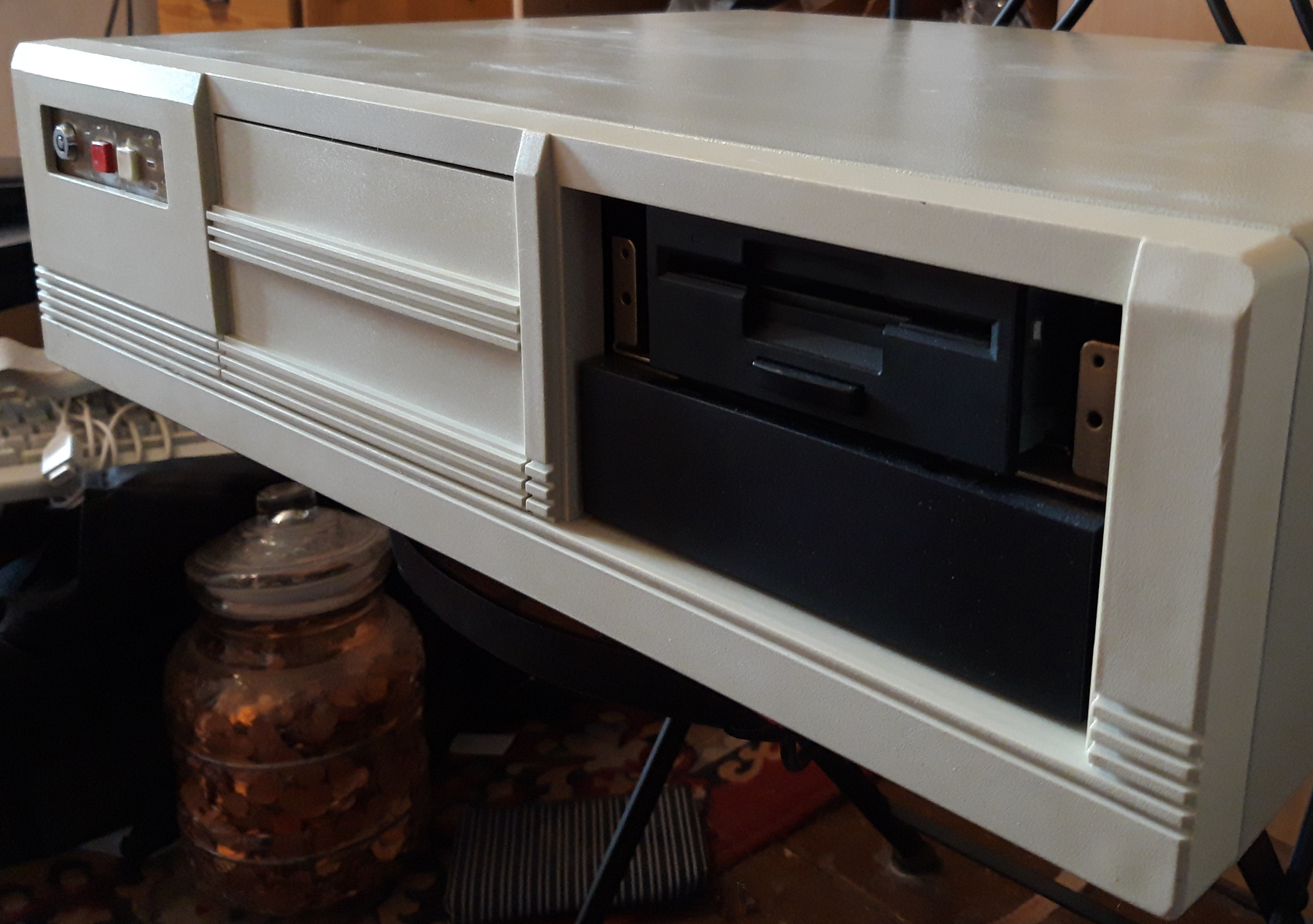

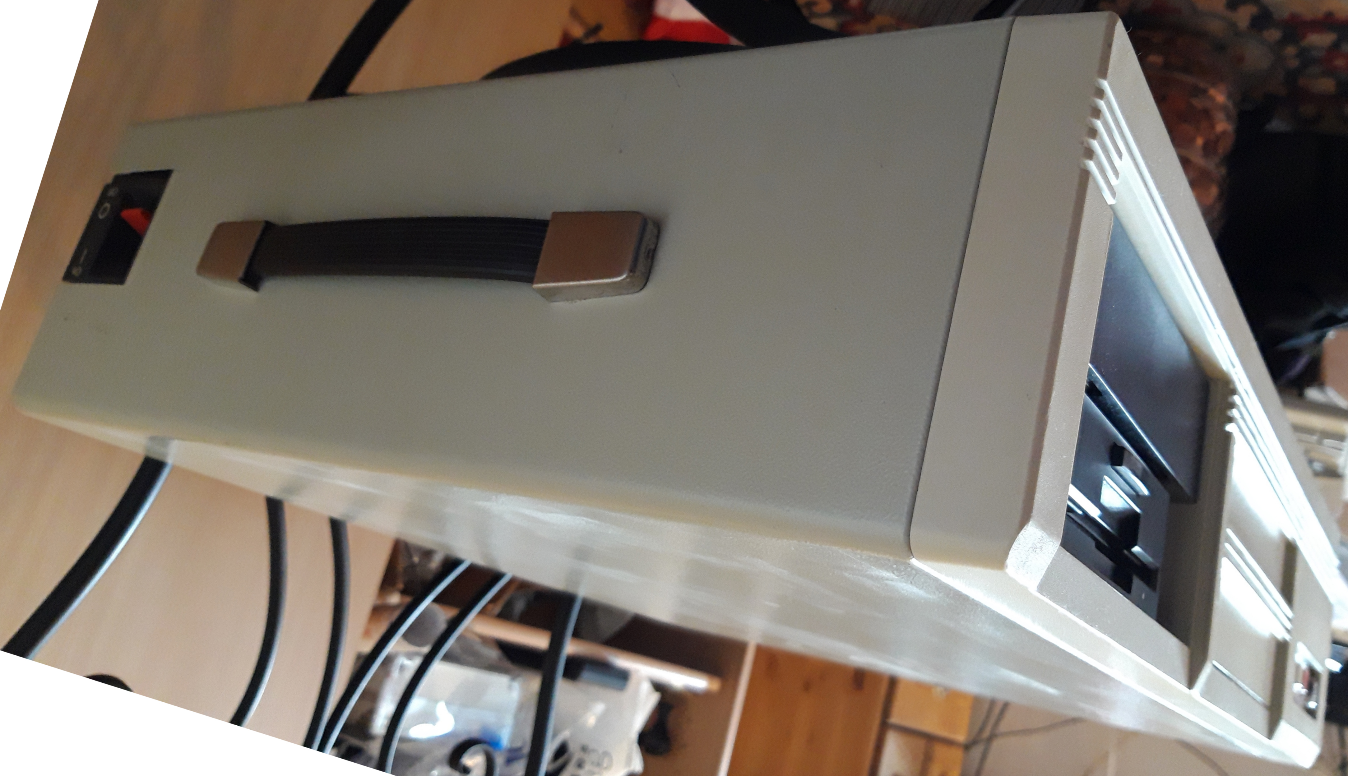

Not in this case though! This is my custom-cased QL that I bought a few months ago. Before now I was embarrassed to show pictures of it externally. This is how it came (sellers original pictures). It had been stashed away somewhere for 20+ years and was not only very yellowed, but was also very mucky inside and out. The previous owner was also a smoker (in fact it looked and smelled like his partner, kids and pets also smoked - no offence PO, if you ever see this, I'm still chuffed to own it!). I'd previously done some retrobrighting on a ZX80 and some Amiga keys. So used the same method here. After a lot of scrubbing and then a rotating bath of H2O2 combined with 2x 30W UV LEDs for 2.5 days, these are similar shots of what it now looks like: Result I reckon! (hopefully it stays that way).

Thanks. I did actually think about spraying the whole thing black to simply cover the yellow, but that probably wouldn't have been the right thing to do as any future chips or scratches would look bad. I actually have the original receipt for the case from early 1990 (79,- DM I think). Even if it does tone over time, which seems to happen for certain things, I don't think it'll ever be as yellow as it was.tofro wrote:Too bad it's still white

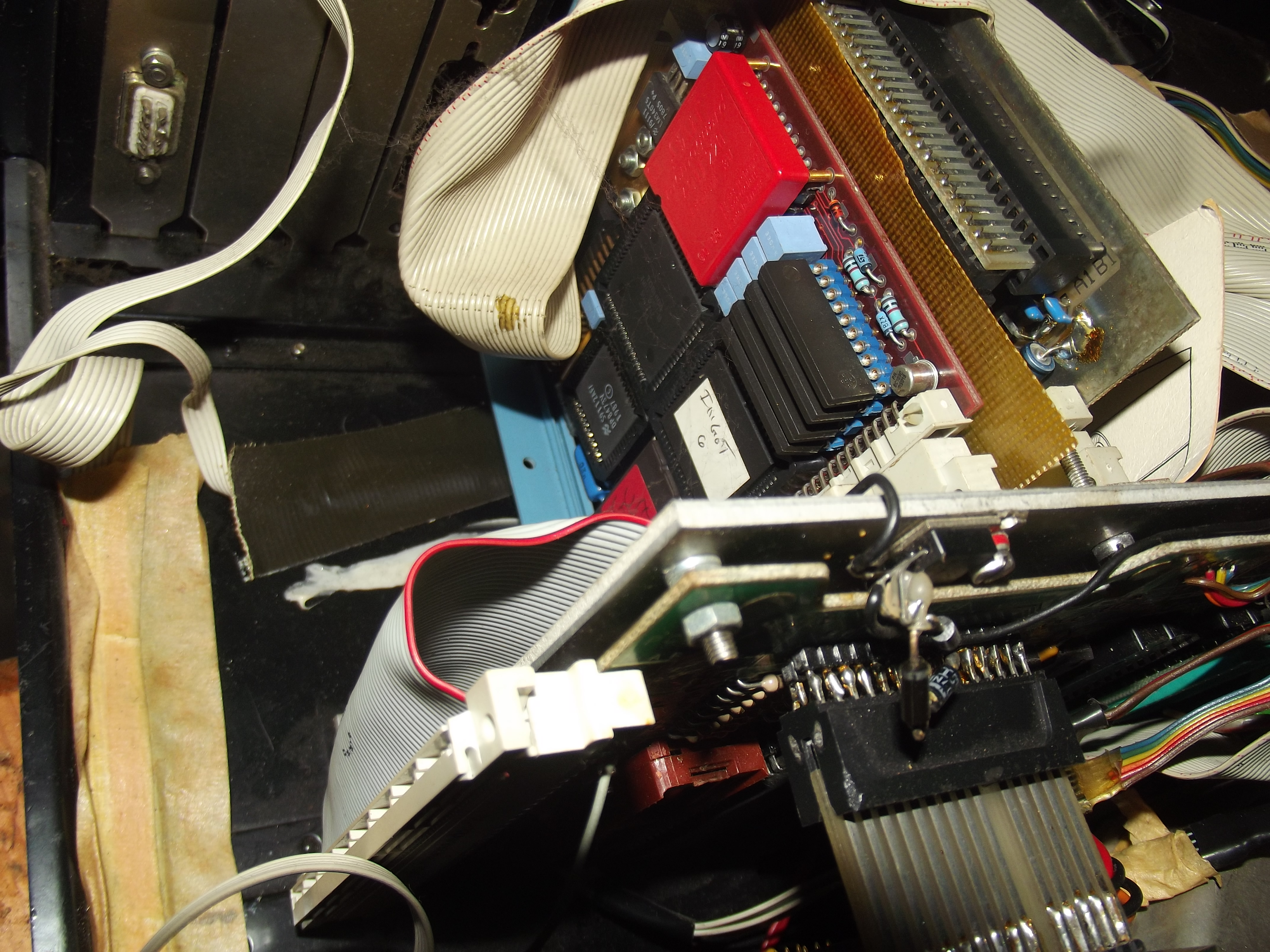

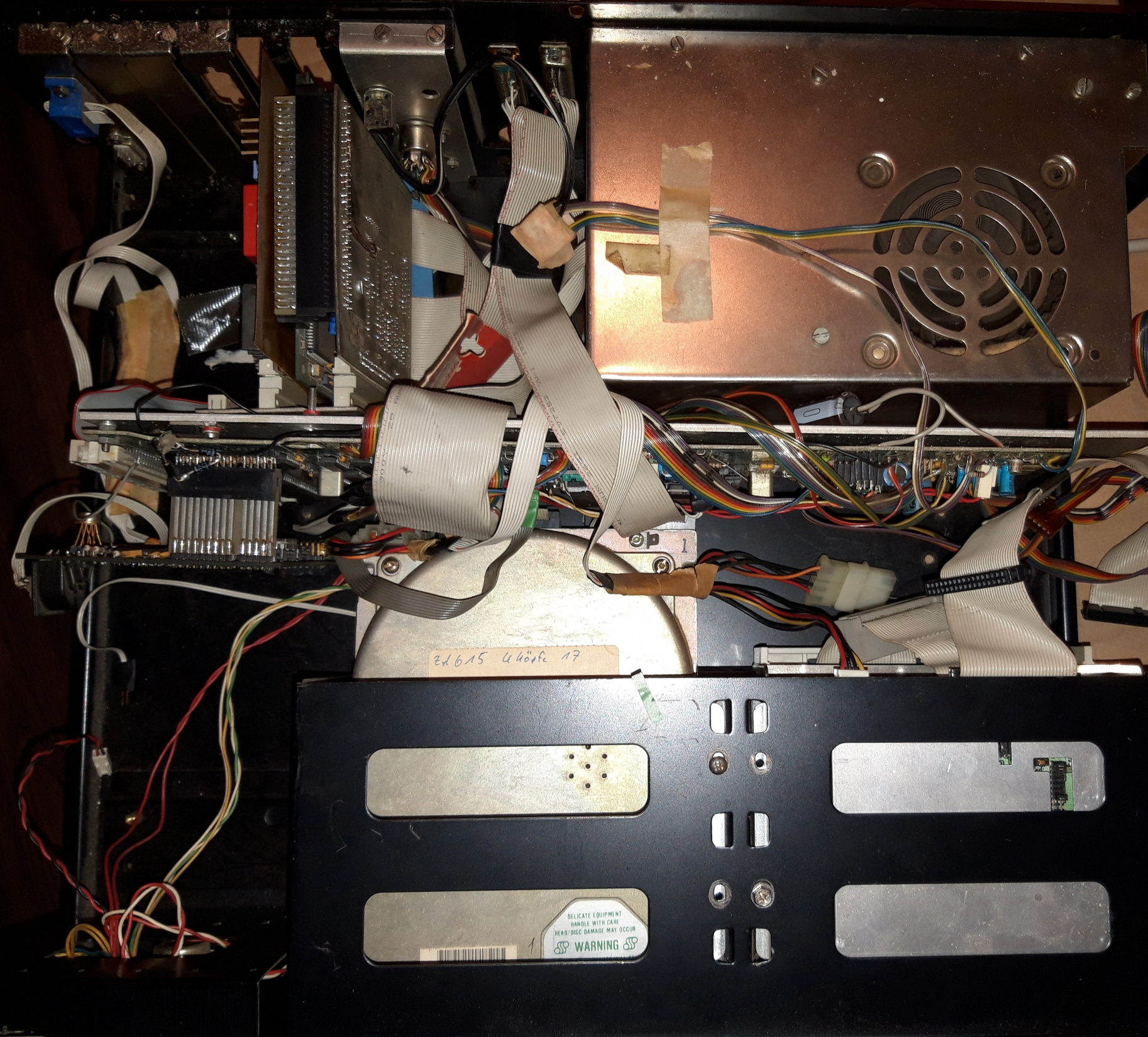

Not very good ones. This should give you an idea. It's basically a standard QL board on it's side, large MFM 20mb HDD and FD's in front on the board. Backplane attached to the exp port, which goes round the back where you can see the HDD interface card (which is attached to a standard PC ISA HDD card) and gold card. The ROM port has been changed to go straight up in relation to the board and on that is the XT keyboard interface. PSU obviously top right. It has Qimi and some other stuff going on. A bit of a tight fit but quite clever the way the original builder squeezed it all in and with a handle as he used to lug it to places for work.Derek_Stewart wrote:Hi,
