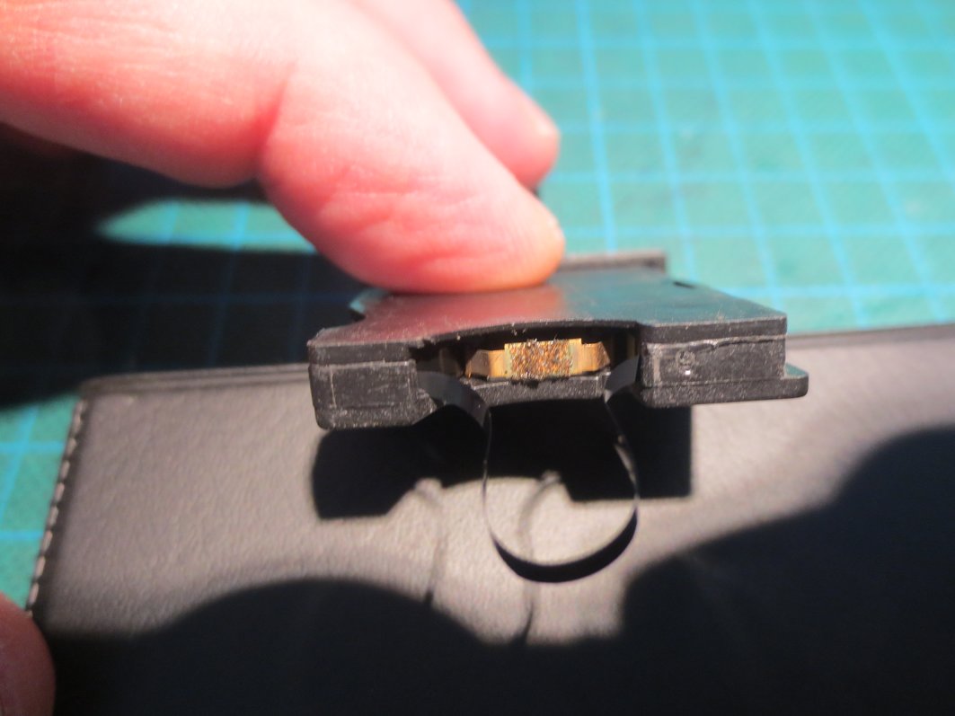

I actually saved one but killed two others. It's not easy. The end is glued on and doesn't come out easily. Next time I want to perhaps leave the end alone and just cut along the inside edge of the end piece. Getting the thing to spool in is a real pain. I used tape to hold it in place until I got it back together. Still works but the other two I could not get back. I still have a spool of one of them and may try again. Insane how they were manufactured.Chr$ wrote:^Agreed, jammed ones can't realistically be saved.

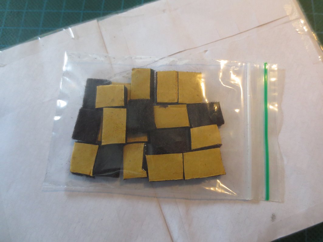

pad replacements have arrived

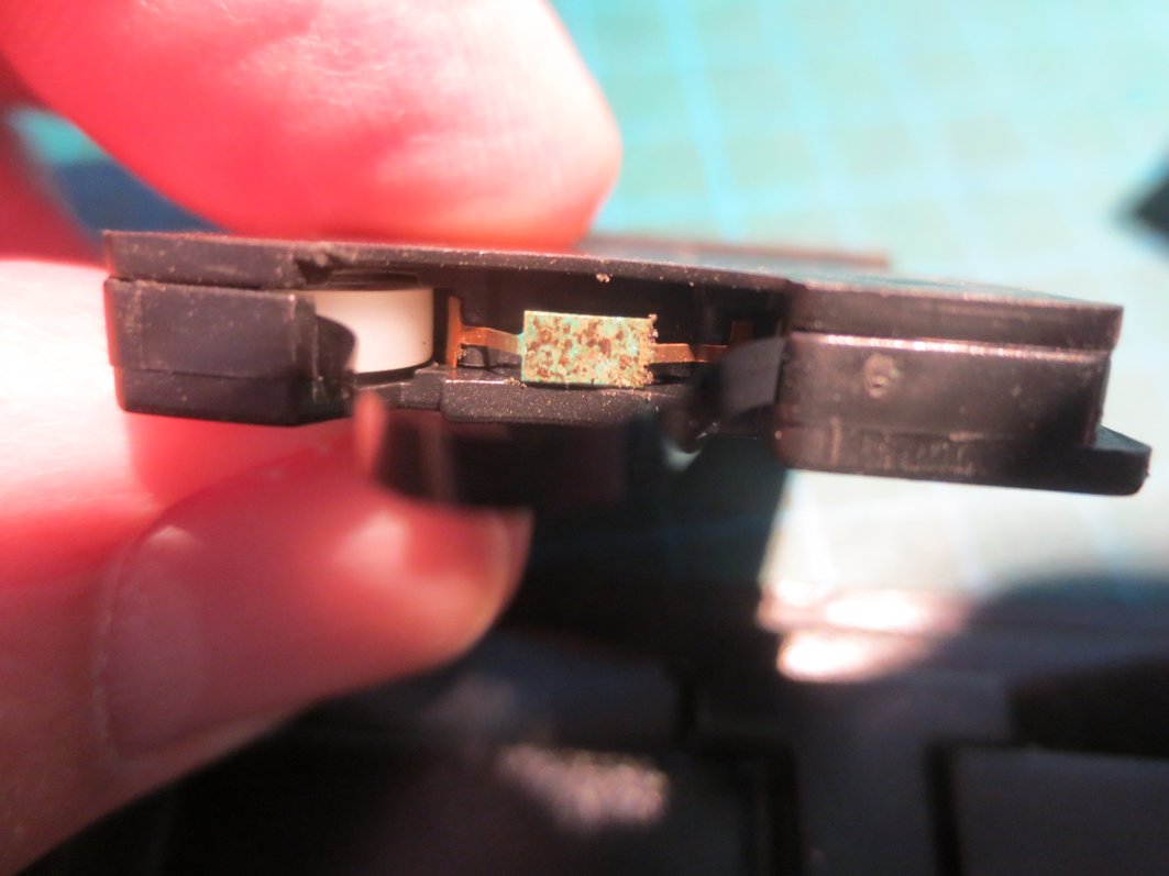

update !!
today i have " refelted " several cartridges and found out that there are at least 2 versions of the brass spring/bracket .
the wide long version does not generate any probs , but the small short ones are a " pita " as the felt tends to bendoverbackwards on those .............
