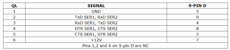

That confuses me more. Dilwyn's site has the pins around the other way, i.e. from the back on the port, pin 1 is top left etc.
Then I don't fully understand this chart:

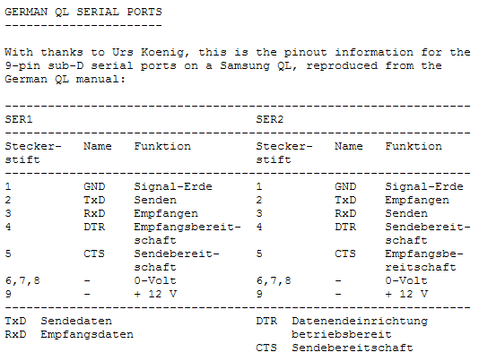

which has e.g. pin 7 as 12v and 1 as n.c.... which is completely different to the info that Urs copied from the German QL manual (1=gnd and 7 is 0v).
I suppose I should rig something up with connectors that I can swap around easily and should also check for the 12v so I don't put that one where it shouldn't go!

I agree, that table makes no sense. Since I have a US QL I just measured and pin 9 on the DB9 RST232 is giving out a 12 volt signal (grounded to pin 1). So it seems this one by Urs is more reliable:

Would it be possible for someone with more knowledge of the serial ports than I to have a look at the page and check if anything needs to be corrected or even removed? From what I can tell, the D-connector wiring looks more PC-style.
Maybe I should add Urs's diagram to that serial ports page (it's currently on a separate Hardware Docs page at http://www.dilwyn.me.uk/docs/hardware/index.html near bottom of page. Perhaps I could just cross-link from the serials page to this document on that page? Reluctant to make the change without help from someone who knows more about the subject than I do.
It's quite an old page - I remember the "no, it's not that way, it's this way" arguments when I first did that page, nobody seemed able to agree.

bwinkel67 wrote:I agree, that table makes no sense. Since I have a US QL I just measured and pin 9 on the DB9 RST232 is giving out a 12 volt signal (grounded to pin 1). So it seems this one by Urs is more reliable:
This is interesting. If this diagram is correct, this would mean German QLs have SER1 and SER2 reversed compared to UK models. See http://www.dilwyn.me.uk/docs/ebooks/olq ... .htm#comms for the UK model.
On UK models, SER1 is configured as DCE (i.e. a modem) and SER2 as DTE (computer). From a DTE's point of view, TxD is output and RxD is input. But the German wiring suggests that SER1 is configured as DTE (Senden = Transmit, Empfangen = Receive). You can test this by measuring the voltage on an idle port; if TxD is output then you should measure -12V on both TxD and DTR while the inputs should be close to 0V.
The +12V line is not meant as power supply (though some peripherals such as the Miracle Systems modem used it as such!), but to tell connected peripherals that the connection has been established (most notably DSR and DCD should be tied high on the PC end as some software expects this).
Jan
