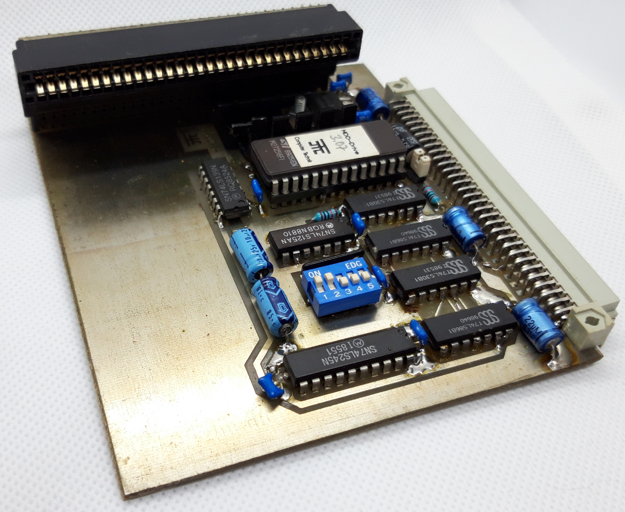

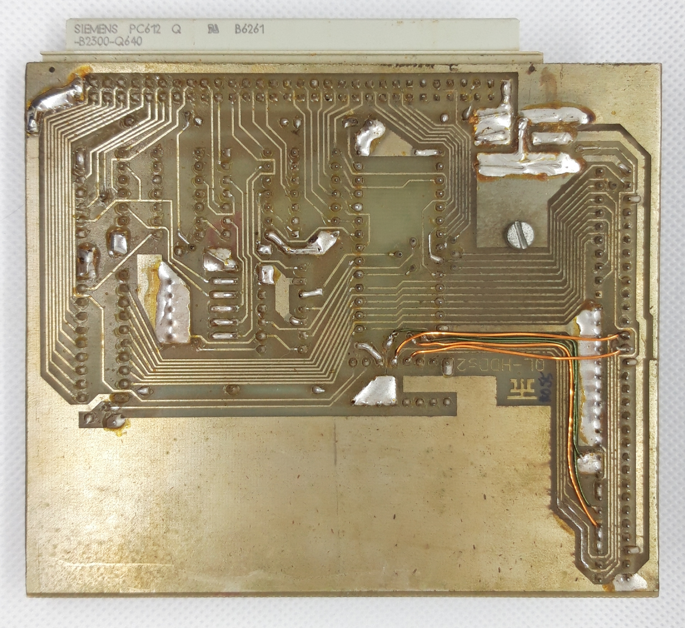

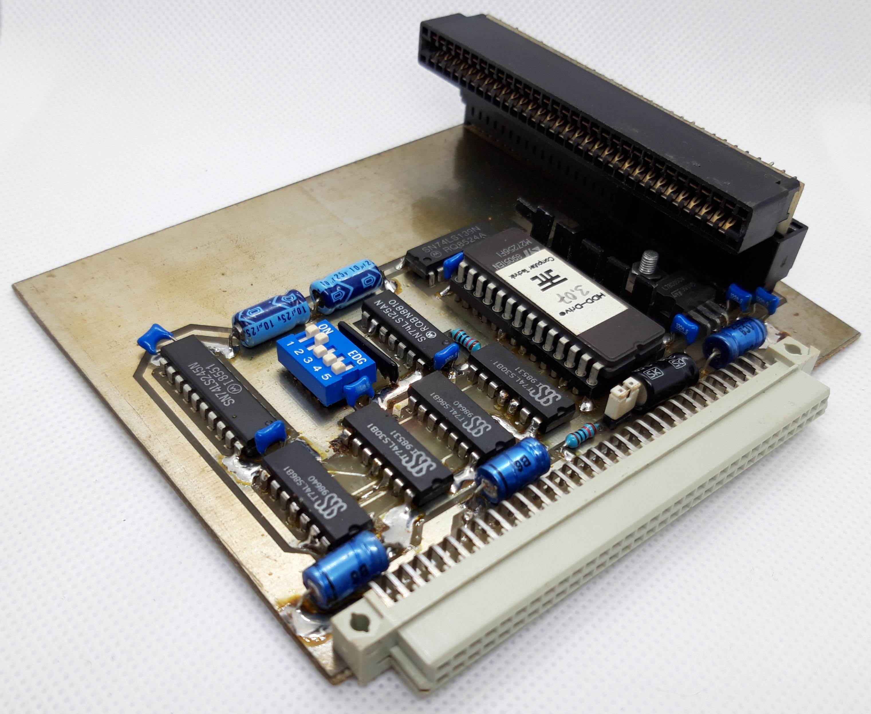

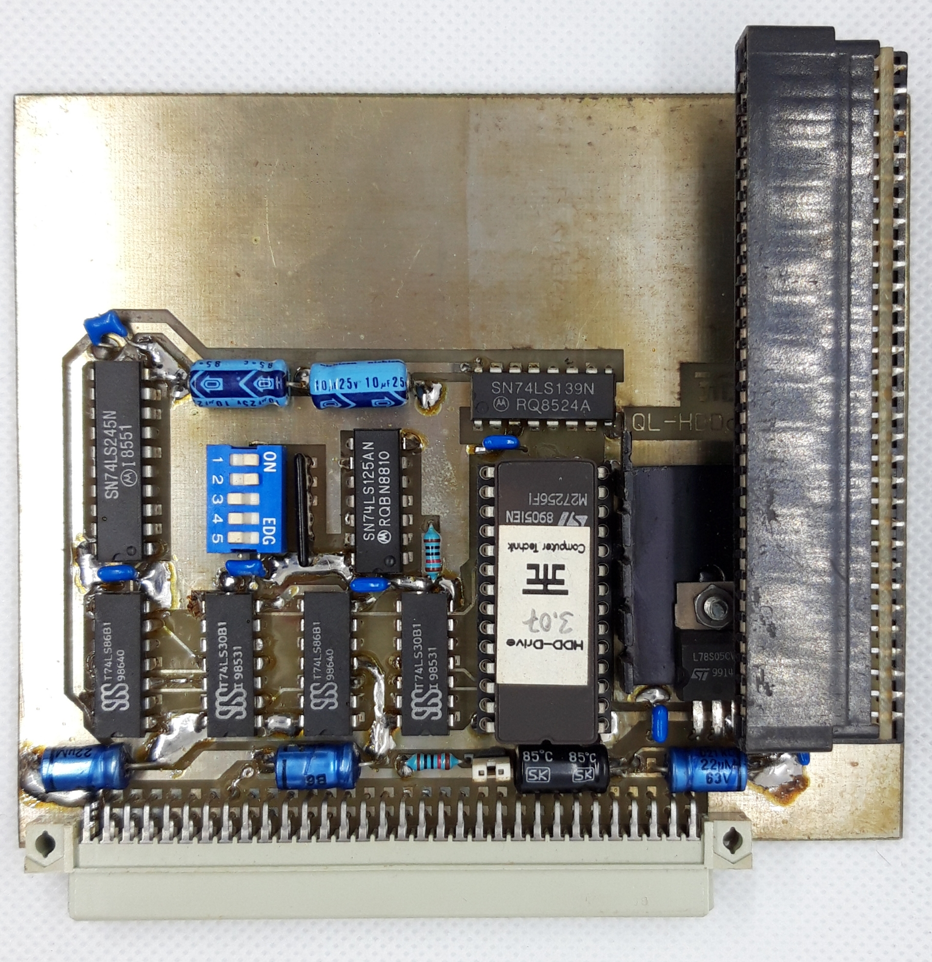

I have a working (most of the time) QL 'beast' with an ABC German Jürgen Falkenberg QL-HDD card installed. By way of a plugged in ISA adapter card it is attached to a monster 20mb Seagate drive.
It looks like this (actually couldn't find any pics of one online so feel free to add to the Wiki https://qlwiki.theqlforum.com/doku.php?id=qlwiki:qlhdd):

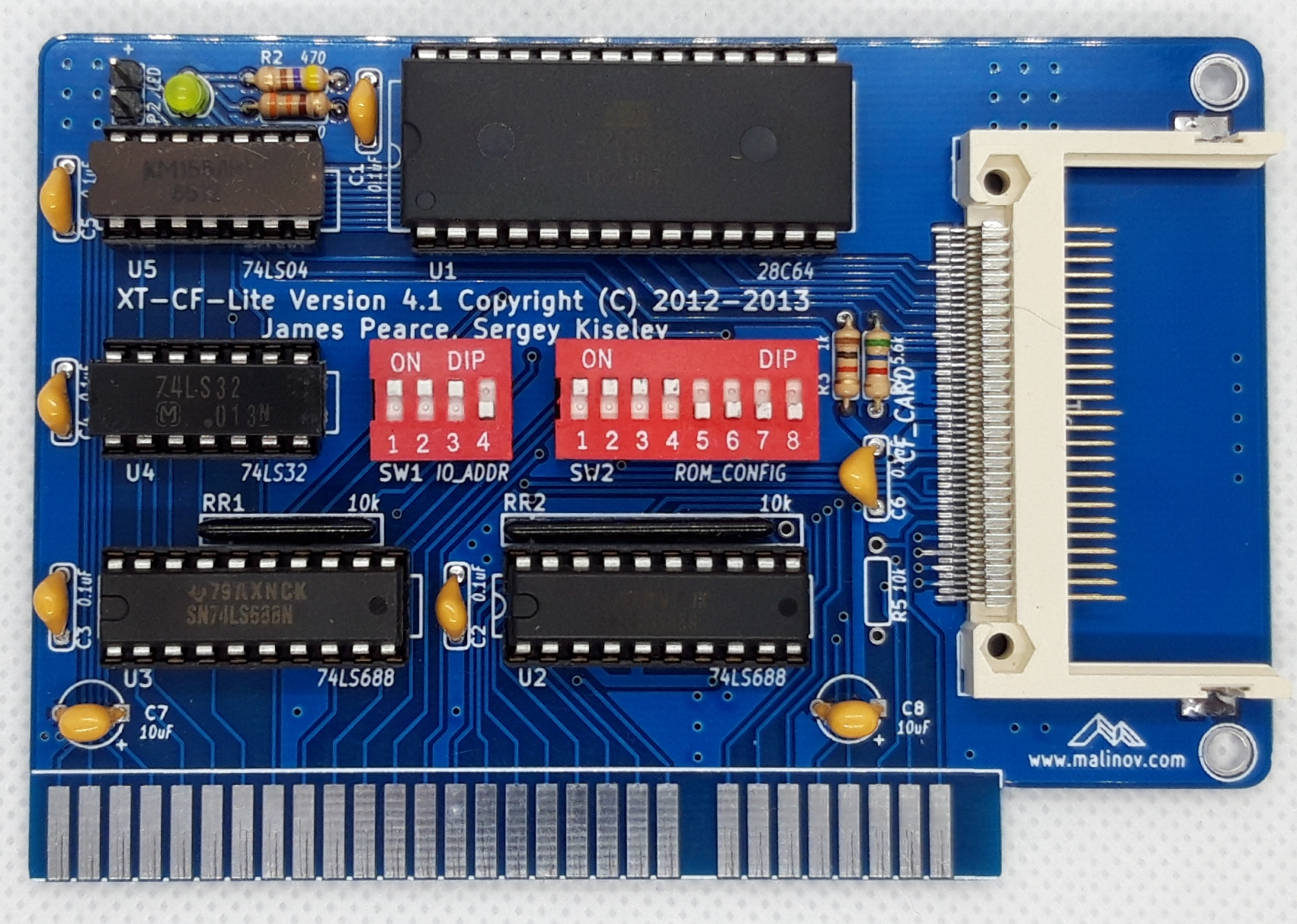

I wondered if it would be possible to do away with the slightly unreliable and very loud Seagate and replace the whole thing with this ISA to CF storage device:
If I were to try that, is there anything I'd need to be aware of? Would I be able to format it with the Falkenberg provided winform_exe (which I don't think I have) or would I need to use something else? (the original instructions refer to the QL-HDD only being compatible with a small number of RLL or MFM drives).

For future reference (and for any one that ever searches for it), here is the ROM data from the Jürgen Falkenberg QL-HDD card. The EPROM is an ST M27256FI and is labelled "HDD-Drive 3.07" with a logo and the company name Computer Technik.

It is definitely not an ISA card, but a PC/XT card. Both the original card and driver do not support IDE/ATAPI and therefore no CompactFlash.Chr$ wrote:I have a working (most of the time) QL 'beast' with an ABC German Jürgen Falkenberg QL-HDD card installed. By way of a plugged in ISA adapter card it is attached to a monster 20mb Seagate drive.
Normally there's no chance without a driver rewrite for IDE/ATAPI. I knew the QL-HD driver quite well, because I rewrote it for SDHC cards.Derek_Stewart wrote:But I think it is worth a try, maybe the CF Card emulates harddrive.
Which, by the way, almost became the original driver release for QL-SD. I always found QL-HD a stable driver, and like the fact that it is partially written in C. I just had to leave some CHS related code active and did not find the time for a full LBA re-implementation. That lack of elegance, and other circumstances, eventually led to a distant Qubide derivative being the first driver released for QL-SD instead.
BUT: The depicted PC/XT card (not the CF card) might do the job of "translating" MFM/RLL to IDE. That is unlikely. It looks more like an IDE controller for PC/XT that has been "pimped" toward CompactFlash.
Update: I searched for "XT-CF-Lite" and it is indeed just like a PC/XT IDE controller, not implementing an MFM/RLL interface. No chance with unmodified driver.

Thanks Peter. Understood. In that case, I won't even bother trying it then!Peter wrote:It is definitely not an ISA card, but a PC/XT card. Both the original card and driver do not support IDE/ATAPI and therefore no CompactFlash.Chr$ wrote:I have a working (most of the time) QL 'beast' with an ABC German Jürgen Falkenberg QL-HDD card installed. By way of a plugged in ISA adapter card it is attached to a monster 20mb Seagate drive.
Re: QL-HDD card with ISA-CF as Win1_ Possible?
Yes with a small change in the SMSQ/E IDE driver. But that would be pointless since it is only an 8 bit interface, while the Q60 ISA bus has 16 bit.Derek_Stewart wrote:Would the XT-CF-Lite work in a Q60?
If you want to use card media in the Q60, an IDE to SD card converter is the much better solution.
