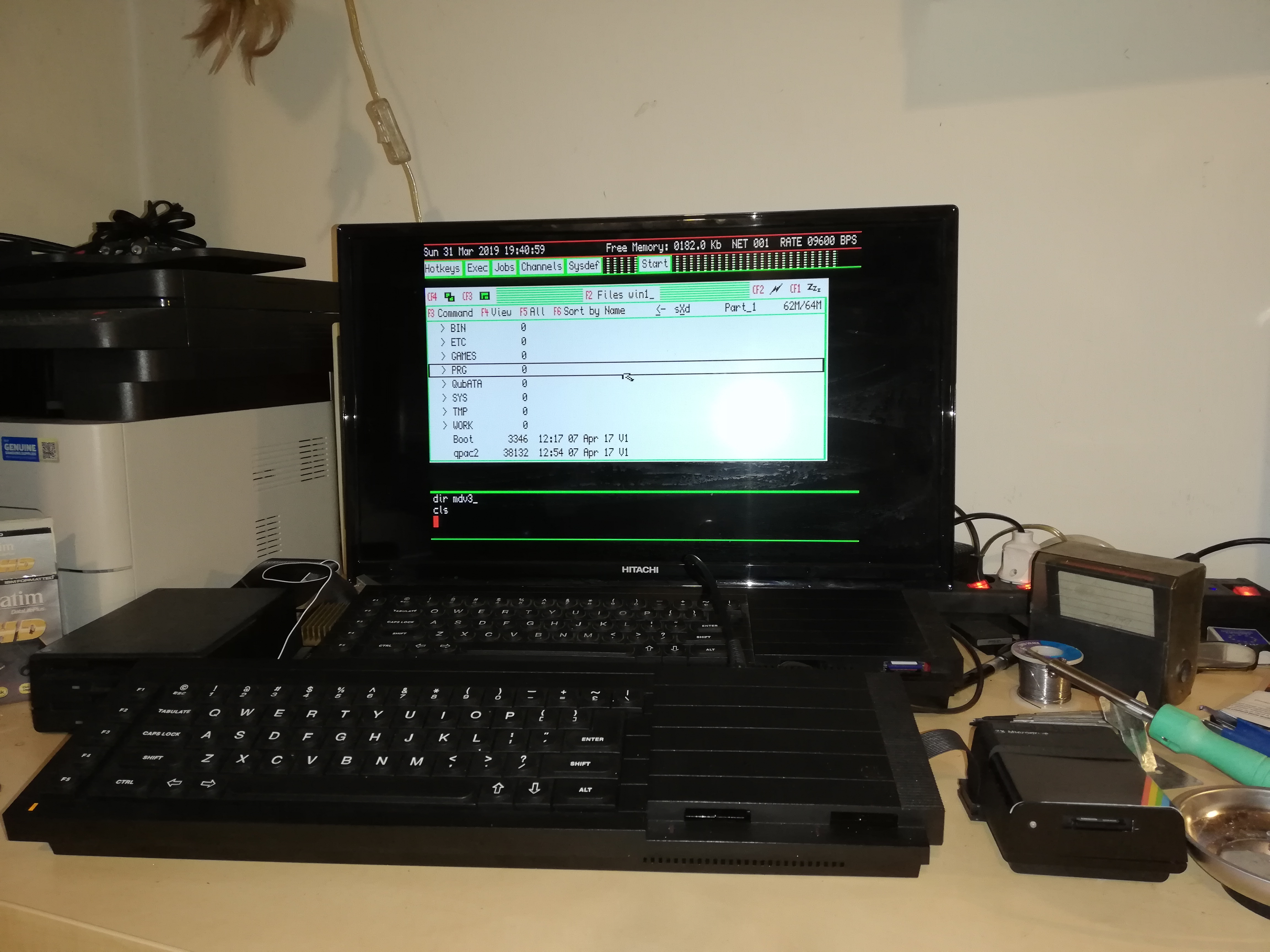

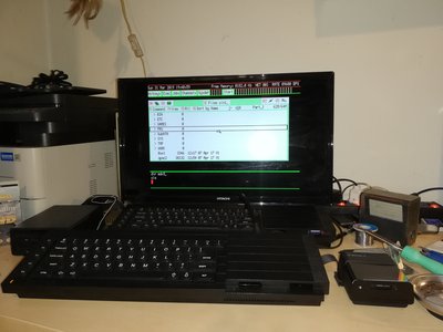

And it's working !
- new keyboard membrane
- new Tetroid power module
- Tetroid QUBIDE with DOM and 512k expansion
- vDrive QL with vMap (it makes it easier to exchange files with emulators and other QLs)
