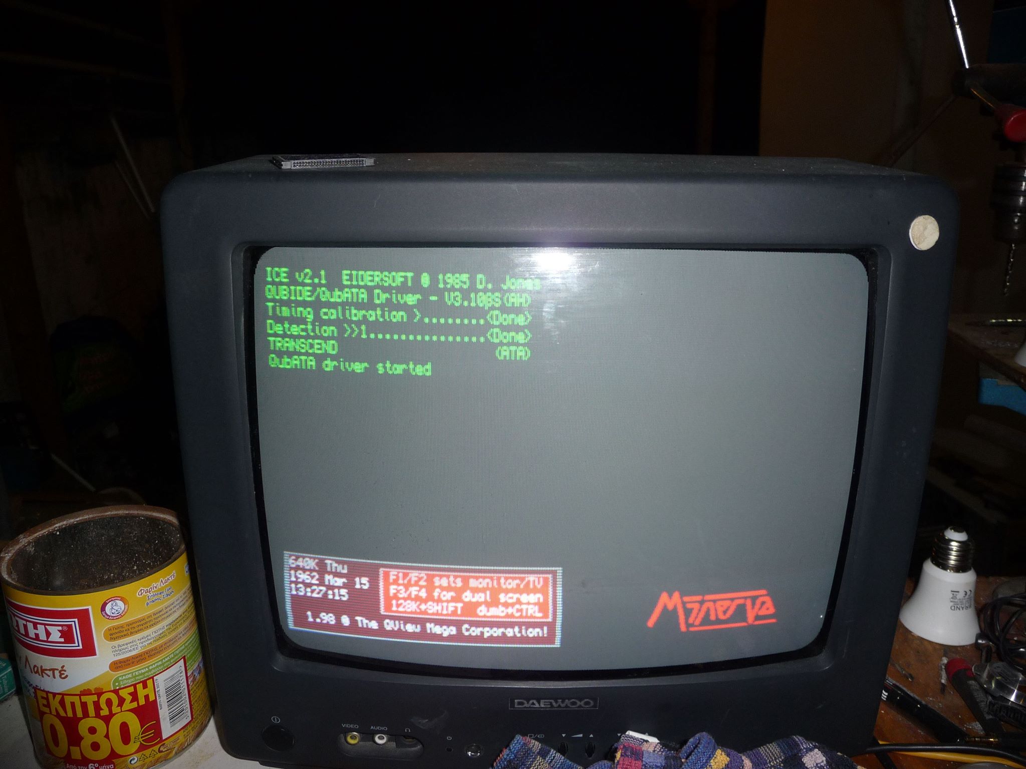

if you have a qubide on the ql you cant have the mice fitted ?
actually the ql will se only the quibide???
the qubide have a 5 pin configuration... for be compatible with the roms(48k-64k) and with other periphericals(trumpcard/goldcard)
so i got 48k and the jumpers is open-open-close-close-close
ok its work but the ql see only the qubide not the mice
so i read read read.... and i found that the jumpers is the rom port.... as is o-o-c-c-c the qubide its fits on the rom port..so the ql see only the qubide but not the ice....
so i change to close close close close open..... and it works.....
now i can see with a GUI the win1_ but only yu can se folders or files on win1_
it freeze if you try to open a folder.....
(i try olso the ice on standard o-o-c-c-c as a soft and freeze olso(black screen with clock))
AND NO I WILL MAKE THE QUESTION
THERE ANY 68008 DISSASEMPLER ?????????????????????? A DOUND THE K68. BUT THE LINK IT BROKED
I WANT TO TRY TO REWRITE THE ICE TO CAN CONTROL FOLDERS AND SUB OLDERS ON QUBIDE
