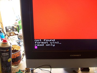

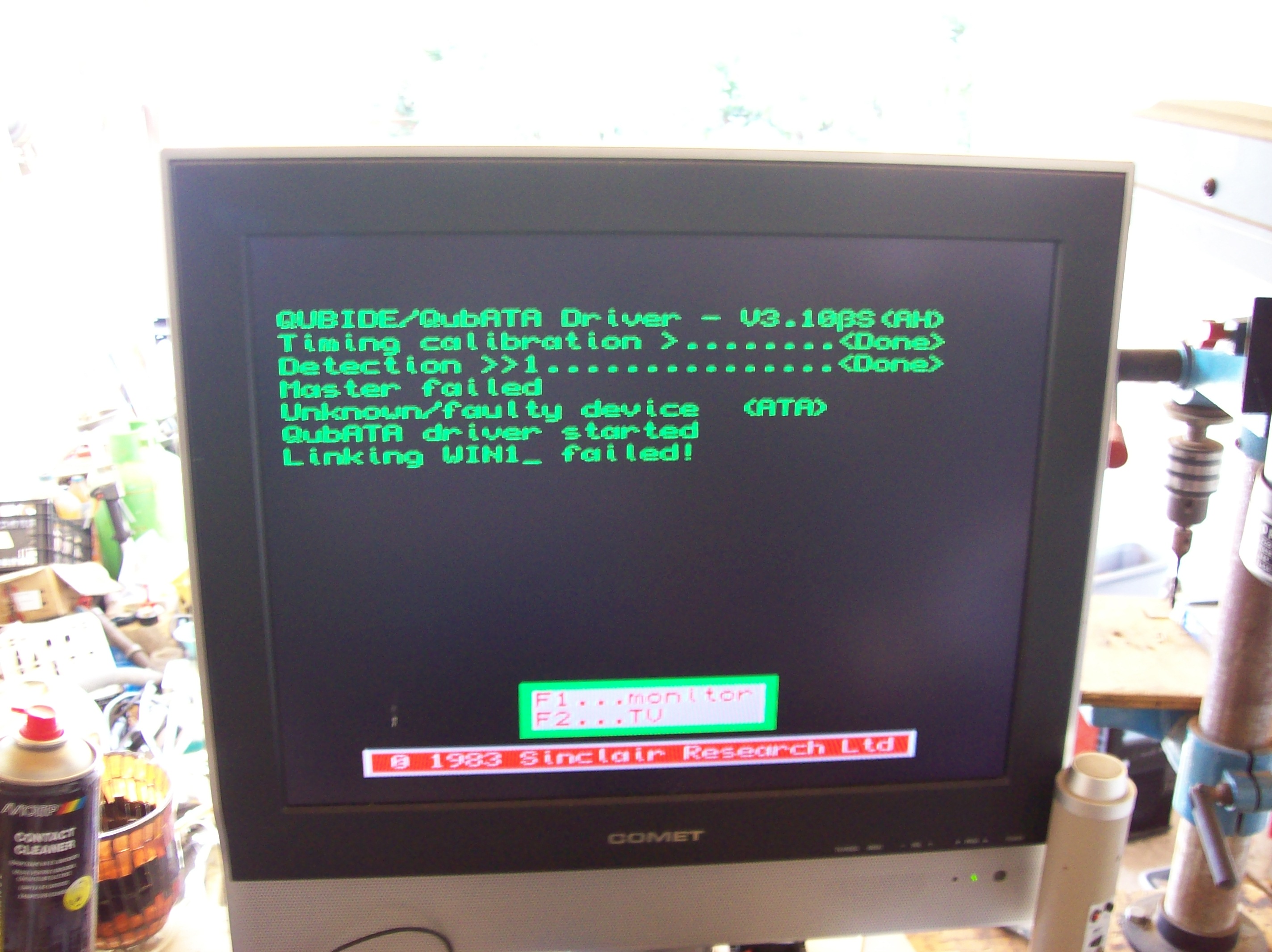

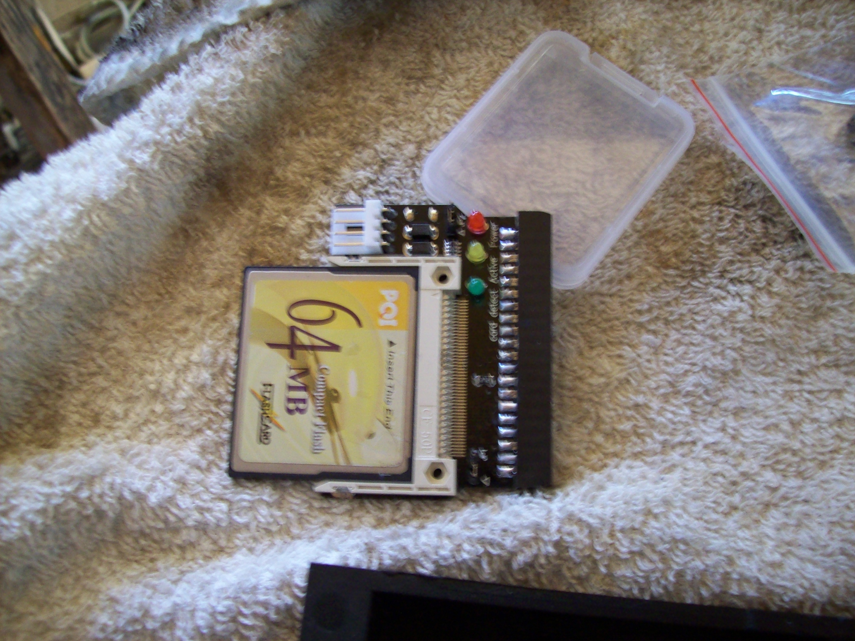

hello how i format a brand new cf card(32mb) on cf-ide adaptor on qubide with qubata 3.10?
the qubide see the cf card like unwone

You must set unlock bit to unlock write protection.
WIN_FORMAT 1
Read the manual.
cats-chess.narod.ru/QL/DOCS/QubATA_TDI.pdf
Posts: 4840
Re: qubata 3.10
Assuming the CF Card adpter is setup correctly as a master IDE device try:
Win_format 1
Win_disk initialize,1
Win_disk create, 1,1,sizeinmega
Win_drive 1,1,1
Format win1_name
Where name is the name of the partition.
There are some good examples of how to create WIN partitions in the manual at page 13 & 15

second command not found
Posts: 4840
Re: qubata 3.10
Sorry for the error, thd second command should be:
WIN_DISK "init", 1
I was quoting someone else and not the manual.

NOT FOUND .......
MAYBE INCOCAPABILITY OF CF... OR PROBLEM WITH THE CF_IDE CARD

Once you've formatted the CF card, can it then be read on the PC?
Artificer
Posts: 171
Re: qubata 3.10
Post by Artificer »
It might be the adaptor. My experience has been that not all IDE CF card adapters work well with the Qubide adaptor. I possess an adaptor that is visually identical to the one shown in the posts above and could not get it to work with Qubide and Qubata software. But some do work well. See the post here http://qlheaven.blogspot.com/2017/07/co ... r-and.html showing a CF adaptor type that works with Qubide and Qubata in an Aurora build. I bought it on Amazon and it is called a "Syba Best Connectivity 2.5" IDE 44-pin to Dual Compact Flash Adapter". It will also need a 40 to 44 pin converter.

some ones are incompatible with qubide/qubata... :o :o :o :o :o :o :o .i try trancent 128 x80 its works perfect the partition cant be 128 mb....actualy the card its less 128 mb(122 actualy) an suggestions for exe obj unzip on windows? habi soft make the unzip(extract/ql) an the tranfer(non) (i /try olso ql /without extract in tranfer) but the ql say bad parametes (windows think that the exe files are win/dos so dont understand the ql fil header so i beleive thath the win destroys the header) ...olso some other problem is with the 640 k of ide some early programs run on 128 system lersp problem.... any suggestion toy un zip the files on another program? and i fix for lersp??
