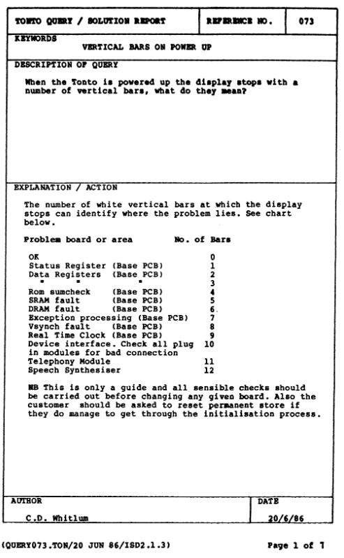

I recently sold a Merlin Tonto which initially displayed 6 vertical bars (SVRAM issue according to the field notes). After replacing the processor board, and general tidying up the machine, it was working.

However, the 6 vertical bars are back, and he can't get past them. He has changed the processor board (with 2 alternatives), and even replaced the SVRAM, but nothing seems to fix this issue.
Has anyone else experience of this and how to get around it?
