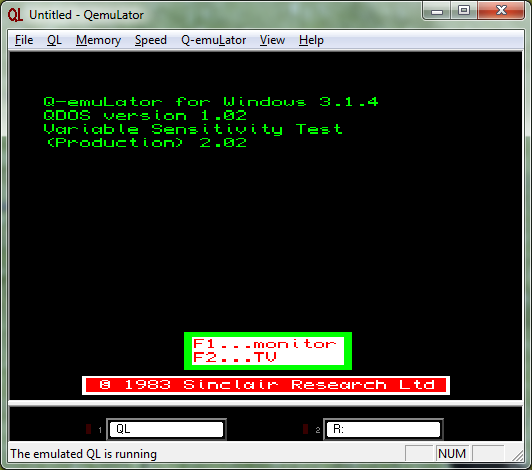

This is how it looks when using the 16K $8000 binary Images in QemuLator:THERE IS AT LEAST ONE MORE FIRMWARE PROJECT I HAVE FOR THE (NEAR) FUTURE. STAY TUNED!

Re: Unique original firmware from the Sinclair Archives
Looks interesting
Do they do anything different from the production ones?

- janbredenbeek
- Posts: 683
Great work!
What's interesting is that this ROM presents itself as QDOS v1.02, like the AH ROM, but the contents are different. Still it's probably closer to AH than FB, as there is about 1.6K more code compared to the (incomplete) FB ROM. On the QL2K emulator the boot file crashed somewhere when loading the Pointer Environment and Hotkeys but otherwise it boots OK. It also doesn't suffer from the 'bad line' bug like FB did.
