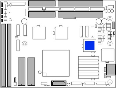

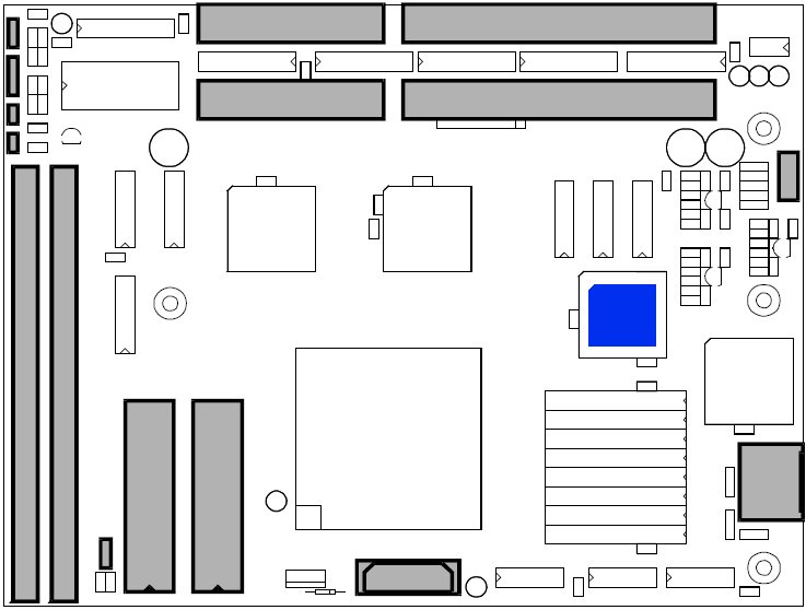

For this change, one of the socketed PLCC chips on the Q40/Q60 motherboard must be replaced, marked in blue:
Partname of the chip is ispLSI1016-80LJ44 (or ispLSI1016-90LJ44). A Lattice programming adaptor is required.
