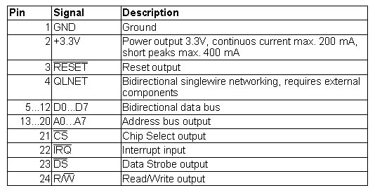

Re: Q68 Notice 3 - Update
The Q68 contains only a minimalistic extension bus with 8 bit data and 8 bit address bus. Suitable for peripherals, but not memory. The voltage levels are 3.3V. Nowadays this should be easier to use that 5V, even for tinkering. Because of the small board size, the spacing of the pads is 2 mm, not 2.54 mm. Okay for connectors or wire soldering, but not suitable for standard IDC cables.martyn_hill wrote:In due course, would live to hear more about the spec of the expansion connector - one of the 'features' of the original QL that keeps me glued is the simplicity of designing add-ons using 8-bit, legacy speed components, prototyped on a breadboard or wire-wrapped. One day I might grow-up and enter the world of SMD and proper PCB design, but until then, my tinkering will remain old-school...
In the Q68 memory map, the extension bus is located at $1D800..$1DFFC. The extenal lines A0...A7 are internally connected to A2...A9 of the CPU, accessible every 4th byte (longword-aligned). This is to make driver adaption to/from 32 bit bus systems like Q40/Q60 easier.
The extension bus also provides a signal for singlewire networking (QLNET) with few external components. This has no software support yet.
We decided not to solder any connector for the extension bus, because no professional add-on cards are in sight. For tinkerers, soldering a socket, or direct wiring should be easy enough.
Due to the already decoded chip select signal, the design of simple add-ons should be even easier than for the QL. And signal quality is better because of short lines and continuos ground plane. Timings are "legacy speed", but I may not find time to write detailed specifications anytime soon. I have never even tried the extension bus myself, other than for the Q68 ethernet controller, which is on the same bus.
