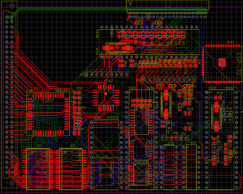

We've almost finished the design of the SSQB interface card, but got sidelined by working on the Issue 8, which is a rationalized QL motherboard. I have put an ESP-32S on it on the far right edge so the antenna is roughly where the 1377 used to be. Nasta believes this may cause some RF problems with the keyboard membrane. I say let's try it and measure the results to quantify the problem, if any.
The goal of the Issue 8 is to do a 'best version' of the QL with clean signals, and omitting the technologies we're leaving behind. Microdrives and UHF/composite video are gone. We have retained the QL net ports for now, because wifi/ethernet isn't actually working on this board yet, but once it is, they will likely go too. The board is heavily re-organized. I have placed the ESP board on the QL serial port 2, before the 1488/1489 using a simple TTL inverter/level shifter.
The Issue 8 CPU card as it currently looks.
Bottom left to right 2x 512K SRAM, 64K EPROM, 8301 with 74HCT245 below, 2x 64kx4 DRAM, 8302. Above the SRAM is a 68008FN, above EPROM is a GAL20V8. Above the membrane connectors, sideways, is the 8049. The ESP-32S hangs off the right side of the board, so the antenna is out from under the metal keyboard plate.
Currently, all IO goes to that 2x20 connector at the back, which then goes to a 2-layer IO board which runs the entire IO length at the back of the QL. This saves around £15-20 per board. The IO board is long and thin, and costs little to make. The 4-layer CPU board is rectangular and optimal for manufacturing. If we didn't do it that way, production on the PCB would be around 3x the cost. The main idea behind this is that as we make improvements, you could replace the IO board or the CPU board. The IO board as currently planned: QL net x2, 9v barrel connector, RGB, 10/100 ethernet port, Ser1 d-sub, CTRL1 & 2 d-subs (German QL layout).

The above all matters as it gives a context to our other decisions. For example, when we design a standalone ESP-32 wifi card, do we do it around existing serial (too slow!) around a common fast UART, or around the SuperIO UART we plan to use in future versions of the QL to replace... well.... almost everything. We have a couple of decisions to make there. I own a huge pile of SuperIO chips, the PC87307. They contain, conveniently: 2x 16550 UART (1.5mbaud) 1x parallel, 1x 8477 floppy controller as used on SGC, kbd/mouse controller, battery backed real time clock, power management, 16 GPIOs all in a handy dandy 160 pin QFP package!
