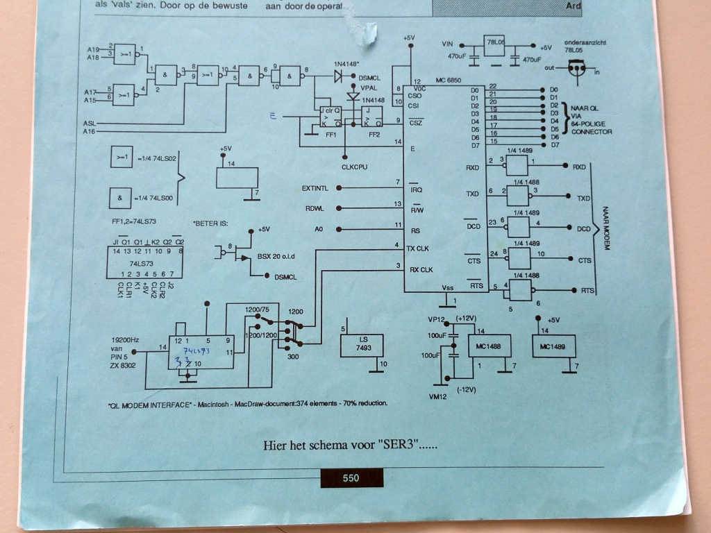

According to my logic probing, BAUDX4 is output by the 8302 to the 8049.
Re: 8302 pinout help request...
Yes, checked - BAUDX4 is an input to the 8049 timer input pin.
I wonder if it's actually a constant frequency (baud rate base frequency) or actually chosen baud rate x4...
Nasta,
as there is a
in the list of documented IPC link commands, I am pretty sure he actual baud rate is generated on the IPC itself. That would imply that what goes into the IPC is a baud rate base clock.
as there is a
BAUD_CMD 13 change baud rate
- janbredenbeek
- Posts: 668
The transmit baud rate is controlled by the lower three bits of SV.TMOD (SYS_TMOD on SMSQ); 000 means 19200 and 111 means 75 baud. This is written to the PC.TCTRL hardware register at $18002 (and bit 3 controls which serial port is used for transmission). The MT.BAUD trap both sends the IPC command and sets these bits.tofro wrote:Nasta,
as there is a
in the list of documented IPC link commands, I am pretty sure he actual baud rate is generated on the IPC itself. That would imply that what goes into the IPC is a baud rate base clock.Code: Select all
When using Hermes as IPC it is possible to have split baud rate for send and receive; Hermes has an 'extended' IPC command (12) to set the receive baud rate independent of the rate set by MT.BAUD.
As the PC.TCTRL register controls the 8302, my opinion is that it's the 8302 which controls the baud rate and the BAUDX4 line is a clock signal to be used by the 8049 to read the incoming RS232 signal.
I'm not sure though how Hermes handles the split baud rates. Perhaps tomorrow after taking a night's sleep
Jan.
- janbredenbeek
- Posts: 668
After making a trip down memory lane I can indeed confirm that the 8302 generates a true BAUDX4 signal. I even used it back in 1987 to drive my own serial port using a 6850 ACIA. I took the signal from pin 5 and set the BAUD rate to 4800 in order to drive my dumb 1200/75 baud modem, thus avoiding the need for a clock oscillator on the SER3 board. See the circuit diagram below (sorry for the Dutch descriptions, it was published in the Dutch Quasar magazine).
Jan.
Jan.
That reminded me - I seem to remember Hermes does not use BAUDX4. The trick is, the 11MHz clock is close enough (0.6%) to the standard 11.0592 standard baud rate generator crystal (Sinclair must have had loads of 11MHz since this, unlike the 11.0592 is not standard and usually MUCH more expensive) is a /3 base clock. The IPC uses clock/12 as it's internal cycle clock (so 11/(3x4)) = 921600. Keep dividing this by 2 and you get standard baud rates. If you feed this to the IPC timer, you can divide it by 1, 2, 4, ...128 (8 total) and use this to generate an oversampling baud rate - or just handle it in software. This is why BAUDx4 was used - it's a standard way of oversampling the serial input so that the actual bit is sampled 'in the middle' and/or disturbances are suppressed by averaging.
If the IPC software generates it's own baud rate, you get a split baud rate feature.
The issue of multiplexing two ports into one is that it relies on external devices listening to their respective handshake signals and not transmit when told not to - if not, the two serial port input streams will simply be OR-ed, and thus corrupted. The actual QL hardware does not physically mute the unwanted input, if it did, only the chattering port would have it's data corrupted, the well behaved one would not.
TBH I'd rather dispense with the multiplexing and have one reliable port with split baud rate capability. The reason is that when both ports are enabled and multiplexing is functioning normally, the combined throughput of both ports is even a bit lower than when a single port is opened (either one) - in which case multiplexing is disabled (the multiplexer is parked in a single position).
- janbredenbeek
- Posts: 668
I've taken a look at the Hermes manual and it indeed mentions that the BAUDX4 line (pin 39) is no longer used.Nasta wrote:That reminded me - I seem to remember Hermes does not use BAUDX4. The trick is, the 11MHz clock is close enough (0.6%) to the standard 11.0592 standard baud rate generator crystal (Sinclair must have had loads of 11MHz since this, unlike the 11.0592 is not standard and usually MUCH more expensive) is a /3 base clock. The IPC uses clock/12 as it's internal cycle clock (so 11/(3x4)) = 921600. Keep dividing this by 2 and you get standard baud rates. If you feed this to the IPC timer, you can divide it by 1, 2, 4, ...128 (8 total) and use this to generate an oversampling baud rate - or just handle it in software. This is why BAUDx4 was used - it's a standard way of oversampling the serial input so that the actual bit is sampled 'in the middle' and/or disturbances are suppressed by averaging.
Well, I believe the ports were designed with the intention to drive a serial printer - at least one of them, while the other could be used for communications. The output lines are not multiplexed and could very well use different speeds. But back in the '80s most modems were dumb and non-buffered so you needed another expensive box (Qconnect) or a more expensive intelligent modem (Astracom or Hayes-compatible) to use the QL's SER ports reliably.The issue of multiplexing two ports into one is that it relies on external devices listening to their respective handshake signals and not transmit when told not to - if not, the two serial port input streams will simply be OR-ed, and thus corrupted. The actual QL hardware does not physically mute the unwanted input, if it did, only the chattering port would have it's data corrupted, the well behaved one would not.
Jan.
