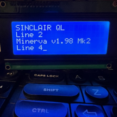

With regards to attaching the LCD to a MK2 Remake the vBat (not used for LCD) is the pin on J2 nearest the crystal
The LCD seems happy to draw it's power from the 5v pin

A slight code mod to make use of all 4 rows (note that the order of the text is line 1, line 3, line 2, line 4)
40  DIM M$(80) : M$="SINCLAIR QL         Minerva v1.98 Mk2   Line 2              Line 4"
