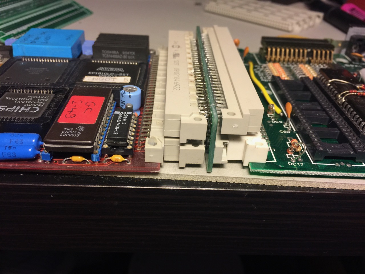

If the magnetics are close to the IC it works fine. I was trying to put them on a short cable so the socket could be located somewhere with more room (can't close the case) but the signal is destroyed. The datasheet also says the magnetics need to be within 3-4cm of the IC.

I placed the jack facing left towards the expansion port. Even very gentle wiggling of the cable makes the board jump out of the socket. The CPU sockets are UTTER CRAP. I will try with it facing backwards (exiting the ROM port) to see if the reduction of leverage helps. If it doesn't, it will have to go elsewhere.
I used turned pins, as I do not want to de-spring the leafs. I could use square pins but they would ruin the socket for anything else that follows. The SPEM internal 512K used to do that too. So obviously that's not an option.

I was not aware you were using a cable. That is of course problematic.Dave wrote:I was trying to put them on a short cable so the socket could be located somewhere with more room (can't close the case) but the signal is destroyed.
From what I read, it's not that strict. They say it "should" be for "optimal performance". With decent differential tracks and ground plane I'm sure at least twice of that is no problem. But since you didn't mean to stay on PCB, that does not help of course.Dave wrote:The datasheet also says the magnetics need to be within 3-4cm of the IC.
Sorry to read you have so much trouble.Dave wrote:I placed the jack facing left towards the expansion port. Even very gentle wiggling of the cable makes the board jump out of the socket. The CPU sockets are UTTER CRAP.
I also have no good ideas for a compact mechanical solution with (S)GC systems.

Yes, currently, with the Wiz830MJ off-the-shelf daughterboard module you do need some way to get the card outside the QL case, be it a through-connector memory expansion card or a backplane extender like XorA and myself are using.Derek_Stewart wrote: Sun Feb 19, 2023 8:59 am I note that the Ethernet card connects to the QL expansion port with a Backplate, is this the Tetroid one, which is not available.
Could the MiniBack Plate idea to fit the board inside the QL Case work?
Ditching the daughterboard and moving the components to the PCB proper would save some vertical space but the Ethernet MagJack connector is quite high, roughly 13mm, which means that at least that component should probably sit outside the case if a MiniBack was in use. I would need some help understanding the mechanical constraints to better see the ramifications.
Current daughterboard approach makes sense during development since the daughterboard module can easily be moved to a new revision of the PCB. For a more mature version integrating all the components on the PCB would probably be the "right" approach.

Independent from CP2200 or Wiz830MJ as controller, finding a good place for the jack in (S)GC systems remains a major problem. I never found a satisfying solution. Which contributed to reduced interest in designing a PCB myself.ppe wrote: Sun Feb 19, 2023 9:54 am Ditching the daughterboard and moving the components to the PCB proper would save some vertical space but the Ethernet MagJack connector is quite high, roughly 13mm, which means that at least that component should probably sit outside the case if a MiniBack was in use.
