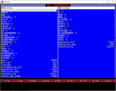

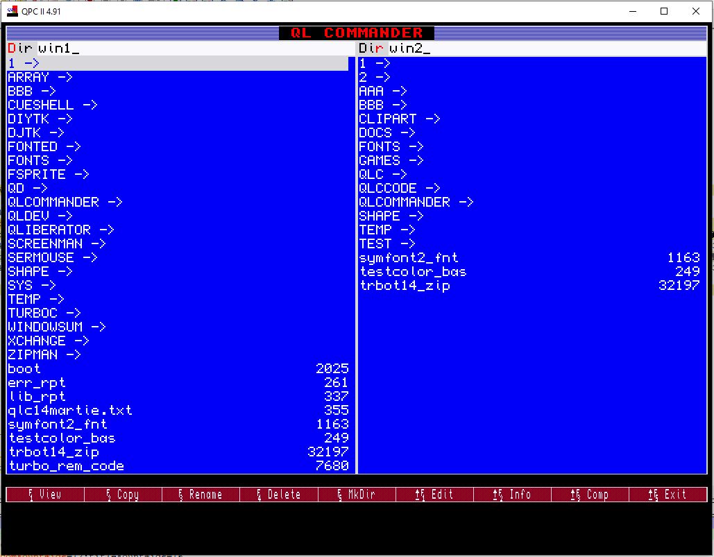

QLCommander running on QPC2 in 1024x768 High Color mode:

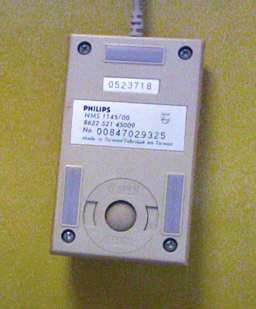

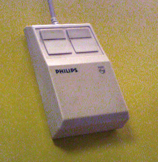

This mouse is tested with my QL (issue 6) and SerMouse driver:
Philips MMS 1145/00

Cristian wrote:This mouse is tested with my QL (issue 6) and SerMouse driver:
Philips MMS 1145/00
Thank you Cristian. I have at home 6 no-name mice that do not work.
Can you send me your sermouse driver, as it is configured on your system ? Maybe I am configuring it wrong
