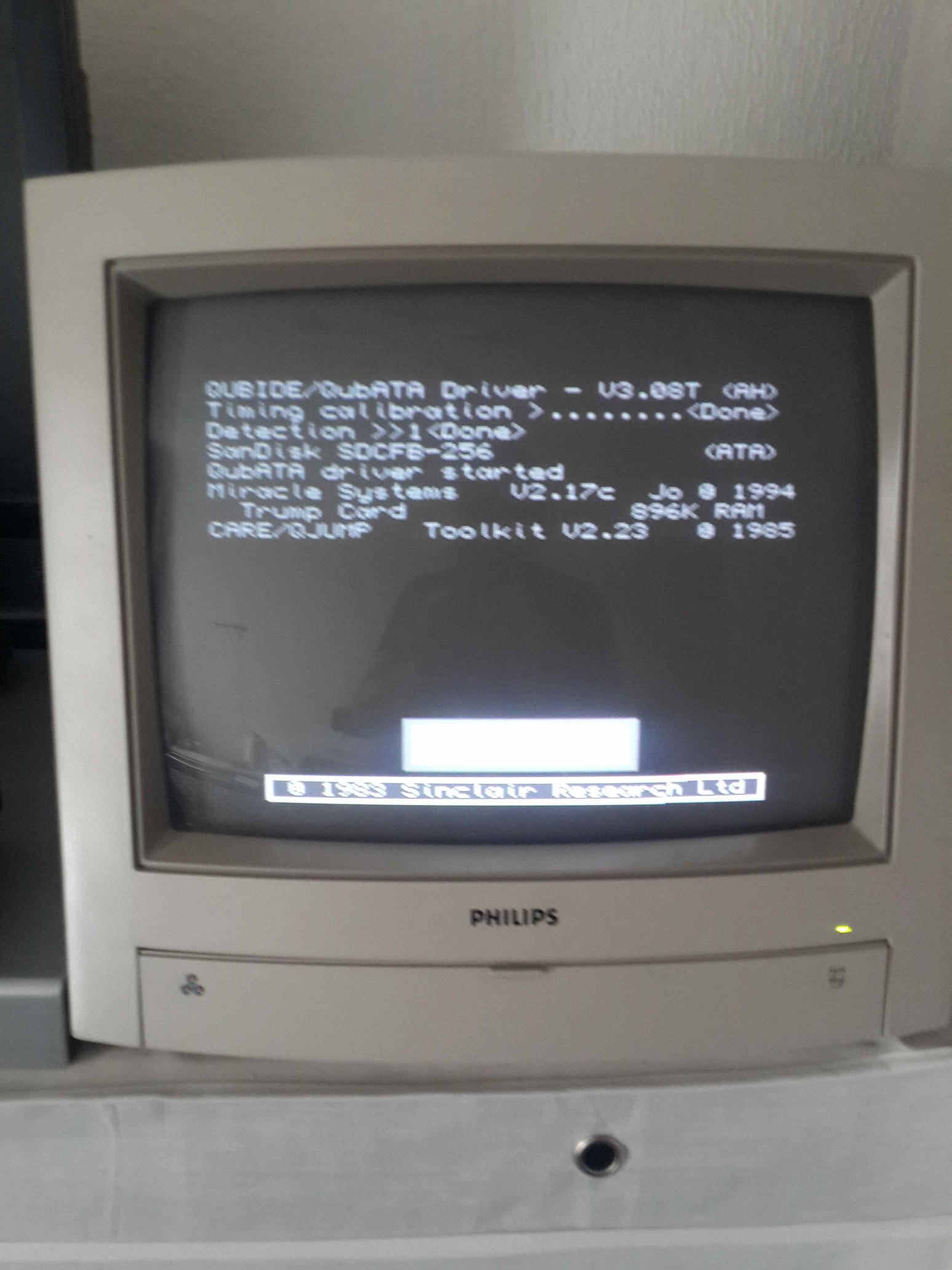

Just updated my QL Interface from Tetroid under Beta Test.
Following the notes at: http://theqlforum.com/viewtopic.php?f=2& ... =70#p16302
Change the jumper settings to 1-2-3 Closed, leaving 4,5 open.
With the new EEPROM and FPGA code produces a new boot up screen, please see the attached photo of my mono QL...
The interface has a 256mb Sandisk CF Card.
not got around to building a Colour cable yet.

I see the interface started correctly.

Re: Announcement - new QL Interface
HI George,
I updated the Altera Firmware with the v13.0 SP1 of the programming software, as Rich says, v9.1 software would not work very on my 64 bit Windows 10 Pro machine.
The Eprom is actually a Winbond W27C512 EEPROM, I used a Minipro TL866CS programmer to erase the EEPROM and programme the chip with the supplied ROM image.
See my picture of the system booting up.
Note, if you update the ROM and not the Firmware, the system gives errors relating the the wrong GALS and you have to move Jumpers 3,4,5 to 1,2,3 or the system will not work.
If you have any problems, I can update the firmware and EEPROM.
