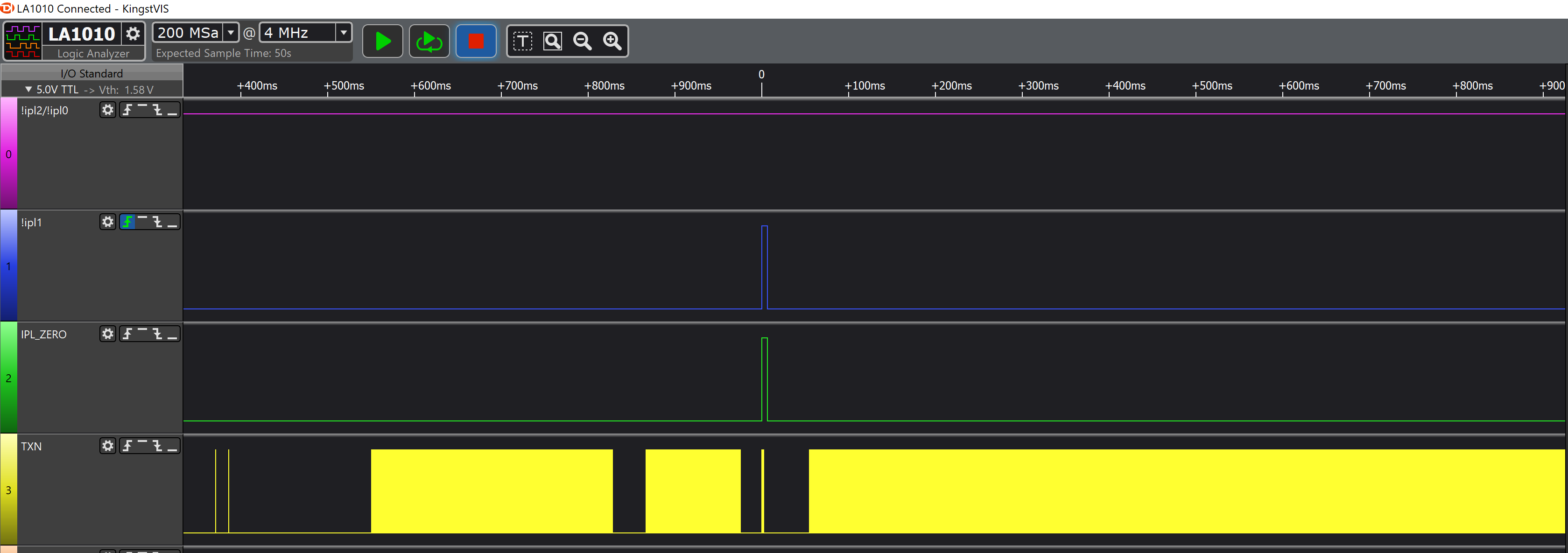

I very definitely have a problem with interrupts. For some reason !IPL1 is constantly low, even before I run the emulator.
The logic analyser is showing IPL0/2 always high, which is correct, but IPL1 is constantly low.
IPL_ZERO should be high most of the time except when an interrupt request is happening on IPL0/2 and IPL1.
Because !IPL1 is always low IPL_ZERO is constantly low too. The yellow trace is TXN ie. a Read or Write transaction in progress.
The first 2 yellow blips are me trying to mask all interrupts and clear any pending interrupts before the main
execution loop of the emulator. The solid yellow is JS booting up. For a single moment IPL1 goes High ie. no interrupts
and IPL_ZERO also follows but IPL1 immediately goes low again.
I'm not convinced I am properly masking the QL interrupts or clearing pending interrupts as I am not 100% sure
what the addresses are or what they need to be set too. There is so much conflicting information and GTP has
got my head in a spin over this inventing new addresses at the drop of a hat.
I'm thinking this could be cause by the delay before booting up. On a real 68000 it would begin immediately and
would set stuff up. Maybe loads of interrupts are happening before the emulator starts running...
I'm also a bit confused by the 3 blank sections of TXN, but I guess this could just be a artefact of the Interrupts
being in such a mess.
Posts: 3209
Re: My current QL accelerator project
Will James wrote: Sun Jul 13, 2025 4:23 pm
Exactly how are you trying to mask and clear the interrupts?

Posts: 3209
Will James wrote: Sun Jul 13, 2025 5:25 pm like this...
ps_write_8(0x18021, 0xFF); // Mask off all interrupt sources
ps_read_8(0x18021); // clear any pending interrupts by reading interrupt register?
I'm pretty sure it isn't right. :D
To clear all interrupts, you need to write the lower 4 bits with 1 (for gap=0, interface=1, transmit=2, frame=3, external=4). Reading only will not clear anything.
To mask all interrupts, you need to write a zero to the upper three bits (for gap=5, interface = 6, transmit = 7). The frame interrupt (50Hz) apparently can't be masked, but is, I think, edge-triggered.
Thus
ps_write _8(0x18021,$1f)
should do what you want. Note if you don't clear interrupt bits, they will keep on triggering constantly.
