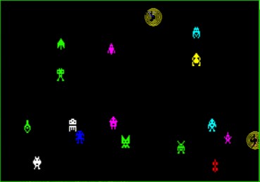

Hi Qbits,
Yes, good idea. It adds spice to the program...
But I had to rename it to DoodleSprite_bas, as Dooddles8q_bas repeatedly gave 'not found' for some bizarre reason.
But the font routine loads OK !
Regards, Steve.
Regards, Steve.

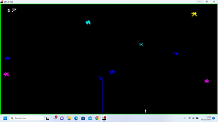

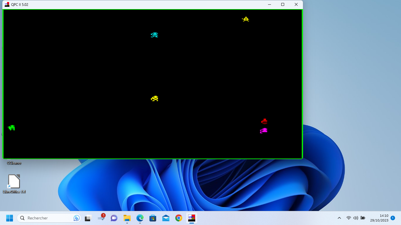

Hi Qbits & All,
It was bound to happen : Converting the brownien sprites program into a game ! So here it is : Just UNZIP and LRUN.
Colliding aliens lose energy (colour), finally to disappear.
Move the man (bottom line) using left & right arrows, Down arrow to fire. (Miss reduces score, Hit increases it.)
Beeps when no ammunition left. Aliens radomly laser-bomb. (Hit = game over). Replays, so try to improve your score...
Unzip to dos2_ or whatever ( Adapt 1630 to your device). Will add REMarks after any reports of quirks.
Regards, Steve.
Regards, Steve.

Re: Doodle
Hi Folks,
Remember, the (ESC)ape and (N)ext keys are still incorporated into the code for you to use, if need be....
Also, as you may have discovered, don't PRESS the arrow keys, just TAP them if you can't make any headway !
I will blank out the score if you don't zap all the aliens, a minor oversight, in the eventual final version.
Fully tested on QPC2. Many thanks to Qbits for his Aliens Font, which greatly improves the overall aspect.
Regards, Steve.
Regards, Steve.

Re: Doodle
Hi QDOS & SGC users,
Here is a tweaked version, adapted to run under QDOS, tested on SuperGoldCard OK, even under SMSQ/E.
UNZIP, LOAD, modify line 1630 for your chosen device and RUN. (You still need the font file on the previous post !)
Use the previous (non-'Q') version on QPC2 etc.... (as relevant QPC2 parts have been disabled here).
Regards, Steve.
Regards, Steve.

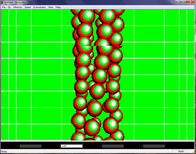

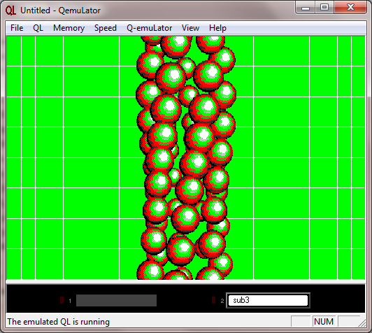

Well, this is my summer doodling...was trying to find a good place to post it. In any case, this is a revision of the KUGLEDEMO_BAS file that does that cool animation of a set of interacting balls bouncing off each other. It's always just been that without a backdrop, so I added one to it. Runs best on a BBQL:
[Edit: Cleaned up the code a bit]
10 REMark -----------------------------------------------------
20 REMark QL-DEMO von Frank Andert, 8670 Hof Ostpreussenstr 14
30 REMark Clubmitglied Region S§D I
35 REMark Modified 6/26/25 by Mike Jonas
40 REMark -----------------------------------------------------
100 s=RESPR(18432) : DATA 8769,8316,2,46,32348,11324,0,255,28680
110 a=RESPR(34) : DATA 8920,20936,-4,53447,20942,-12,28672,20085
120 RESTORE : FOR r=0 TO 16 : READ b : POKE_W a+2*r,b
135 WINDOW 512,256,0,0 : MODE 4 : PAPER 4 : INK 7: CLS
140 FOR i=31 TO 255 STEP 32: BLOCK 511,1,0,i,7: NEXT i
145 j=20: FOR i=1 TO 4: BLOCK 1,255,j,0,7: BLOCK 1,255,512-j,0,7: j=j+j: NEXT i
150 FOR f=0 TO 4,6,5
160 FOR j=0 TO 6
170 INK j DIV 2 *2 , (j+1) DIV 2 *2 , 3
180 FOR i=-1 TO 8
190 FILL 1 : v=(i+8*f) *PI/28
200 y=SIN(v) + SIN(i*PI/4) /3 : r=(5-y)/7
210 x=COS(v)/(1+(2+y)/4) *22 +73.7 : h=j*r/3
215 IF f=3 THEN k=1 :ELSE IF f=6 THEN k=-.2 :ELSE k=0
220 IF j=0 THEN l=.55 :ELSE l=0
225 CIRCLE x+h+k , 6+12.5*i+9*y+h , r*(8-j-l)
230 NEXT i : NEXT j : NEXT f
240 CALL a,s : CALL a,s+9216 : POKE_W a+18,8409
250 f=0 : REPeat l :PAUSE 1.5: f=(f+1) MOD 8 : CALL a,s+1152*f
