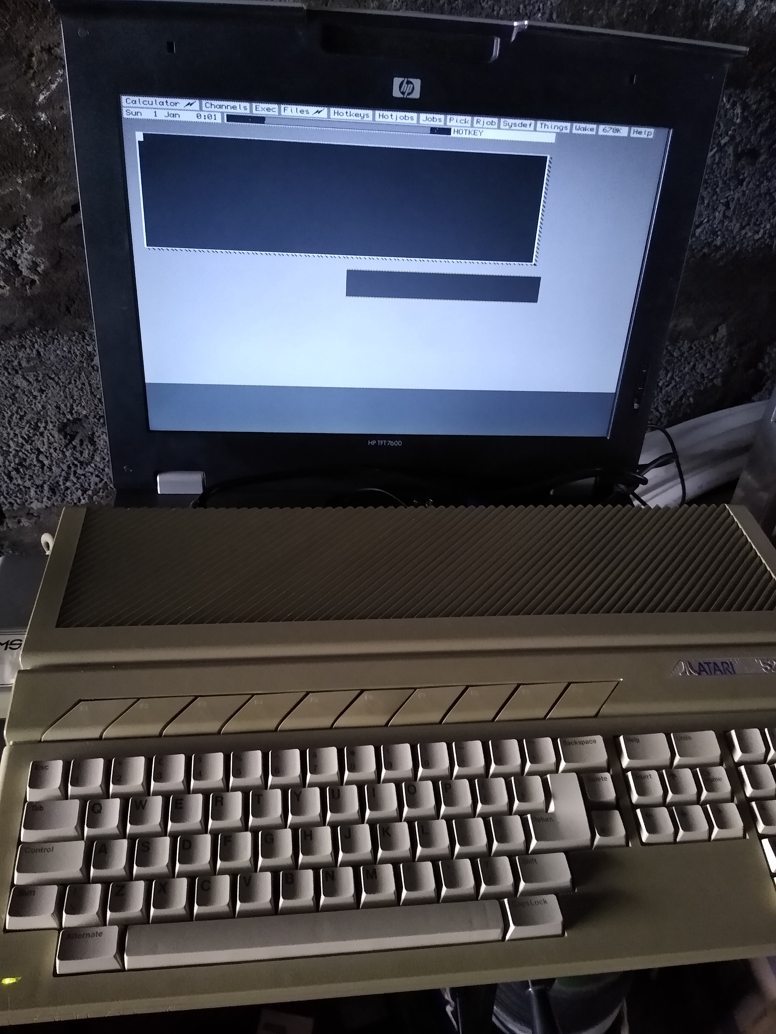

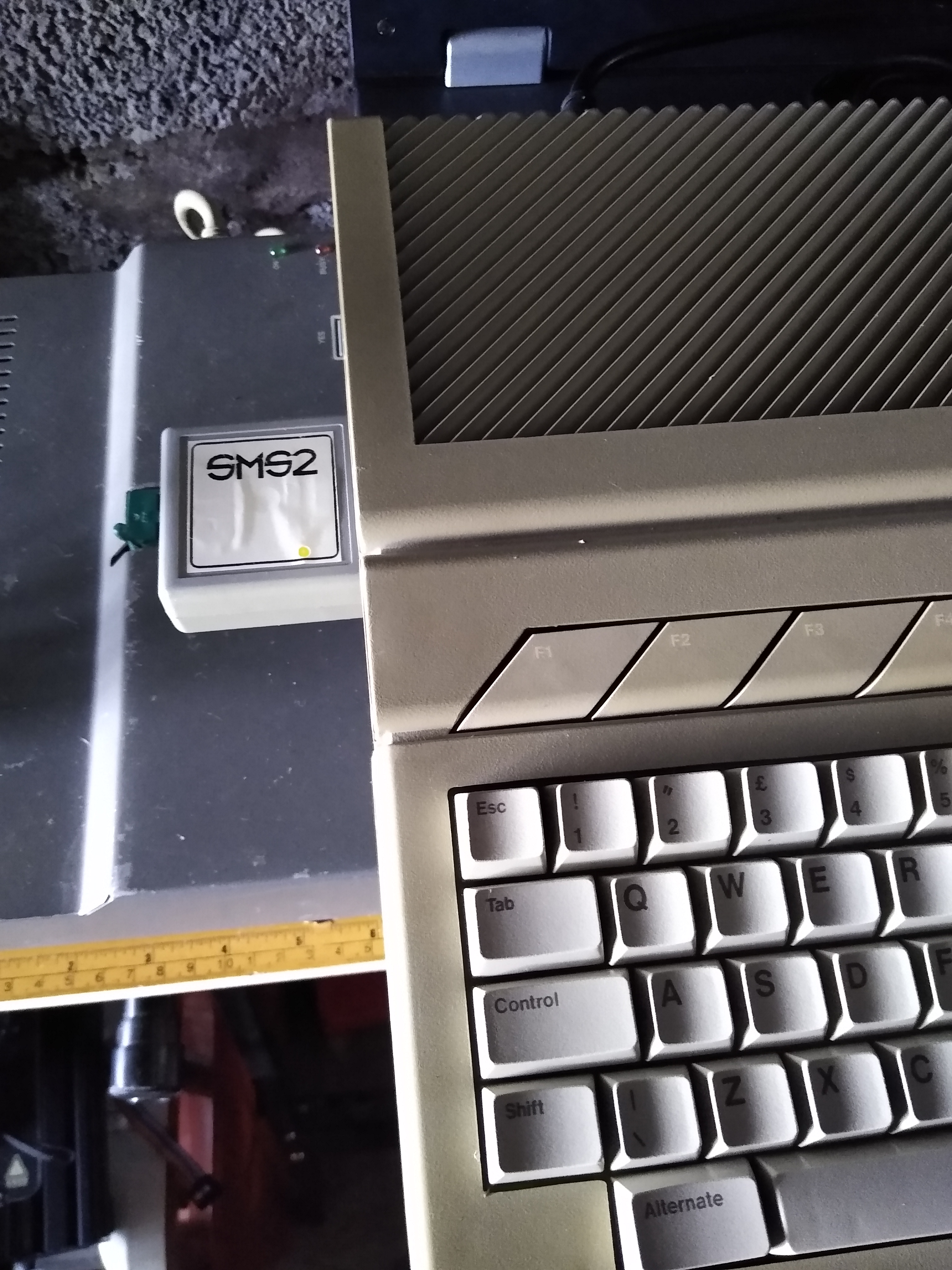

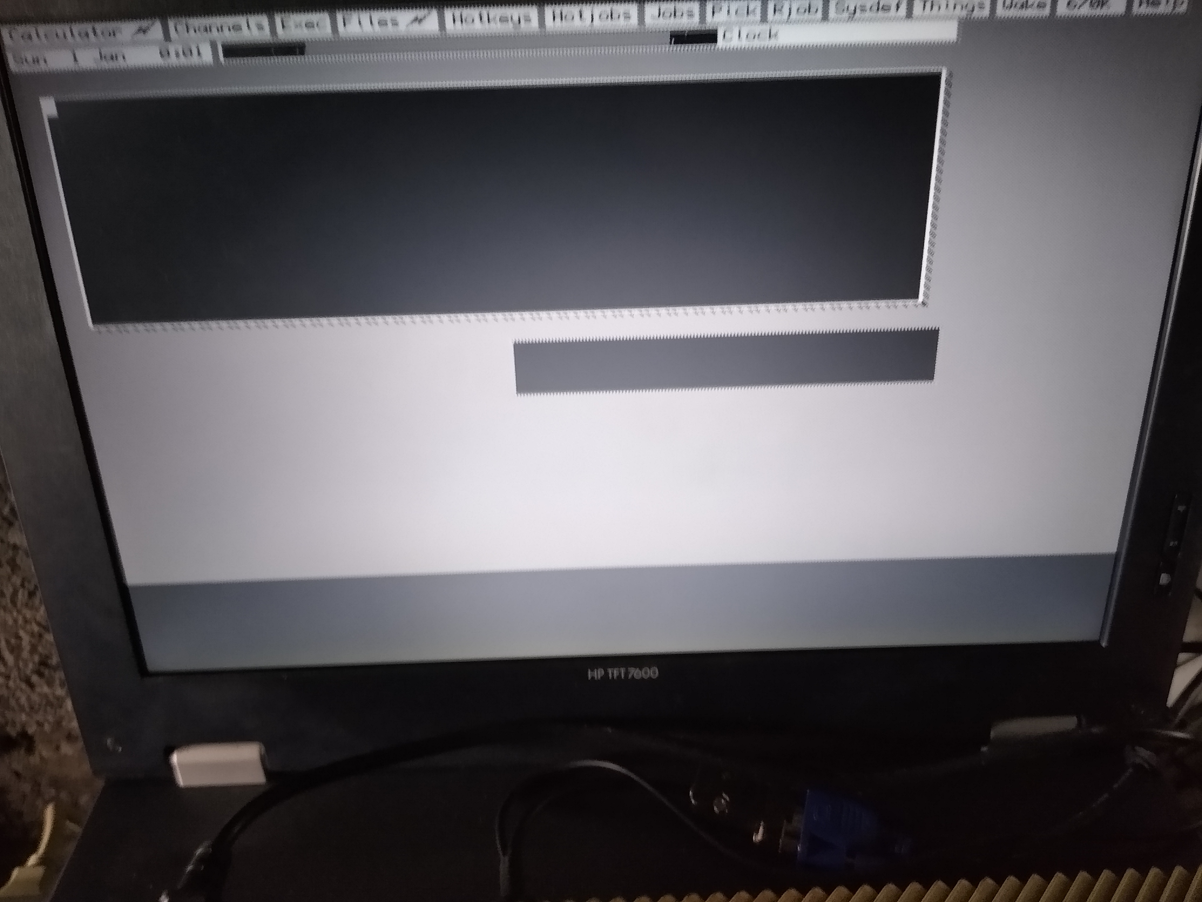

Here is an Atari ST Cartridge that I have been given back, that connects to the Cartridge port of an Atari ST and boots into SMS2.
The 17" TFT VGA monitor uses a ST to VGA adapter sold by Cool Novities.
The Atari boots in to Mono high resolution mode:
My apologies for the rubbish photographs.
The system seems to work on all Atari ST.
I have just got find a way to update the system with SMSQ/E

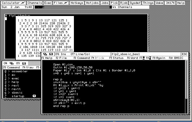

The SMS2 cartridge was a fairly clever design. It is not a pure ROM cartridge. It uses two Atmel
flash programmable and erasable read only memory (PEROM) chips + control logic. It was designed such that SMS2 can be assembled by the user in a modular form and then written to the cartridge using the Atari ROM port.
The cartridge contains 128Kbytes of memory. This is enough memory to hold the kernel, drivers, including networking software, the widowing user interface, runtime QL compatible BASIC system and enough applications to make the system useable on startup.
Once programmed some of the PEROM memory is useable as read/write storage from SMS2 itself. (like SD storage in today's systems)
Once programmed a complete and useable SMS2 system is installed on Atari switch-on. Further software can be loaded automatically from either floppy or hard disc as defined, by the user, in a file held in PEROM.
The most useful additional software, not included in the cartridge, is a QL compatible BASIC programming environment. It is this environment that I now use in my various SMSQE setups. (PC, PI and Q68). ie not the BASIC that is built into SMSQE.
I attach:-
(Again I think) The SMS2 user manual as PDF auto-translated from a Microsoft Word document and thus contains minor translate errors.
A copy of a document I found, probably written by Tony Tebby, extolling the virtues of SMS2. It was probably OCRed because it was full of errors and unformatted. Bearing in mind that I do not fully comprehend the document, I have edited (in .rtf) it as best I can, such that it is readable, and not such that it is accurate. I would have to find the original document to do that.
(Note:- I may have already done this in the past.)
A screen shot of SMS2 in PEROM running on a PC.
I attach:-
