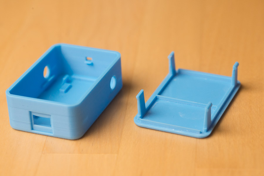

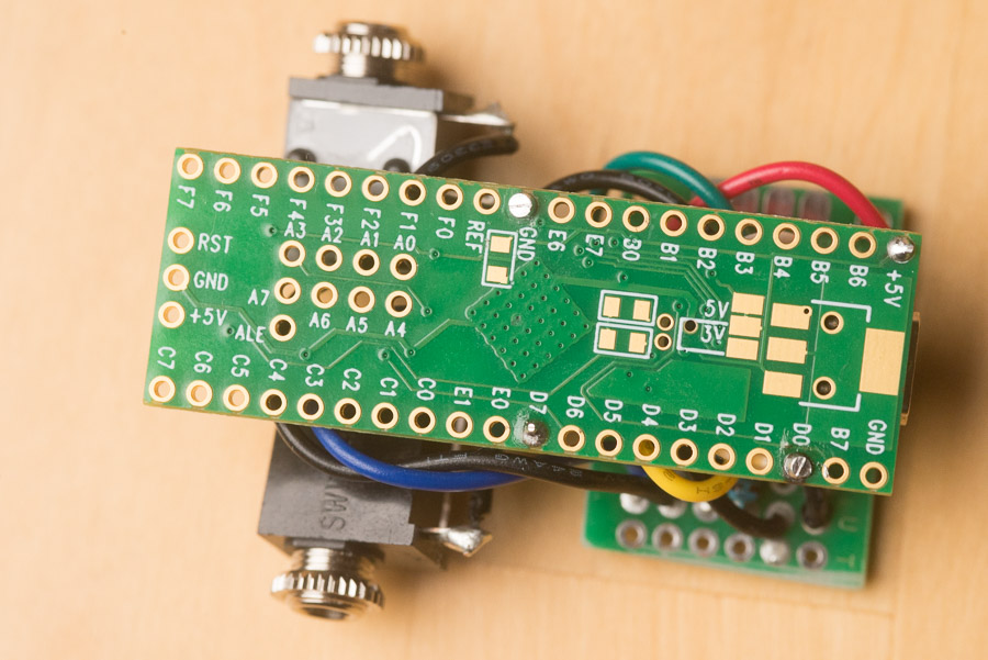

martyn_hill wrote:When you get time, would you be willing to share the overall dimensions/measurements of the apertures, etc? Did you purchase a ready-made project-box, or 3D-print one yourself?
It's a 3d printed box I designed. Here are the STL files:
QLUB_Box.zip
(3.73 MiB) Downloaded 174 times
It's a bit of a tight squeeze, and may or may not work with components different from the ones I used (except for the Teensy board, which has standard dimensions). The LED I used is 3x2 mm.
This is how the box looks when empty, and what I put inside it (Teensy++ 2.0 board, 2 audio jacks, small perfboard, LED connected to D6):
