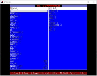

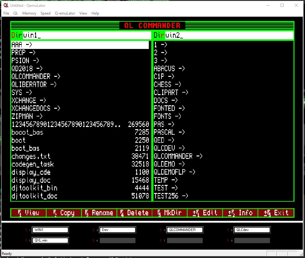

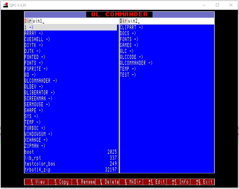

A preview of QLCommander (compiled with QLiberator) running in QPC 800x600 high colour - and on QEmulator :
