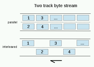

I think the calculations are fine, but work for 4 bits not 8, so the bandwidth is double for 8 bits, or to put another way, your time for 8 bits should be doubled - in a logical sense the 2 heads make the tape double the length, although I suspect the heads are interleaved to guarantee the throughput from system.

But how the tracks are switched to make a single continuous stream?
two track byte stream
The QL Service Manual gives this explanation.
7.3.2 Data is recorded on two tracks using a standard stereo cassette head arrangement and is written in bytes, one byte to one track and the next
byte to the other track. It is recovered in the same way. The tape itself is one continuous loop. Since hardware takes care of switching between
tracks the software sees the tape as one doublelength single track.

@ Dex, picture showing it nicely.
@ Prof, yes the idea of reading two h/w registers, each having one byte of data from either track. Reading is driven by ZX8302 triggering a gap interrupt for MC68000.

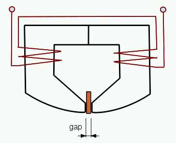

If the above correct then 44 um (microns) of tape must accommodate 8 bits, and that is 2*8 FM transitions, we already learnt.
How could this be at all achieved?
The answer lies in the head construction and tape quality capable of enough magnetic density.
Searching web shows many head types, but principally all work is done by a tiny gap, its width in order of micrometers!
Gap breaks the magnetic tube and its property so called `flux', is forced out, trailing the magnetic states in tiny parts of tape.
We may possibly observe a gap on the head face with a ray of light, coming from an angle?
To visualise, compare the thickness of:
human's hair - 80 [um]
spider's web - 7 [um]
head construction gap
