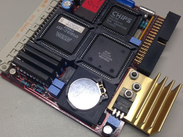

Another photo. :)
This is the final design battery adaptor fitted to a Gold Card. The Super Gold Card has more room, but the Gold Card provides the tightest fit. This is because the PLCC sockets on many of these have bowed out edges that intrude on the battery's personal space. Anyhow, everything fits and is within the maximum dimensions allowed. No case clashes here, thanks to the low-profile battery holder's design. The plastic 3D printed overlay provides a way to handle the board, plus some physical protection and reinforcement for the four legs.
There will only ever be 100 of these made. I have spent well over $1000 developing them and they have gone through three major design revisions in two years. Some will be translucent red, some black - I cannot promise people will get a specific colour, but if you request a specific colour I will do my best to give you what you want. Personally, I like the black.
Enjoy.
Sandy 40LF220 Battery Adaptor, Gothic edition

Now where is that "like" button when you need it?
Nice job there Dave 8-)
:shock: How much development costs :shock:
I'm not fussed on the colour for the three that I have ordered. But with a $1000 development cost I did wonder if there was a gold plated version :lol:

The battery adapter is, in fact, gold plated. :)
Thanks :)
