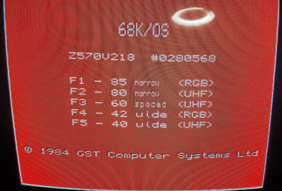

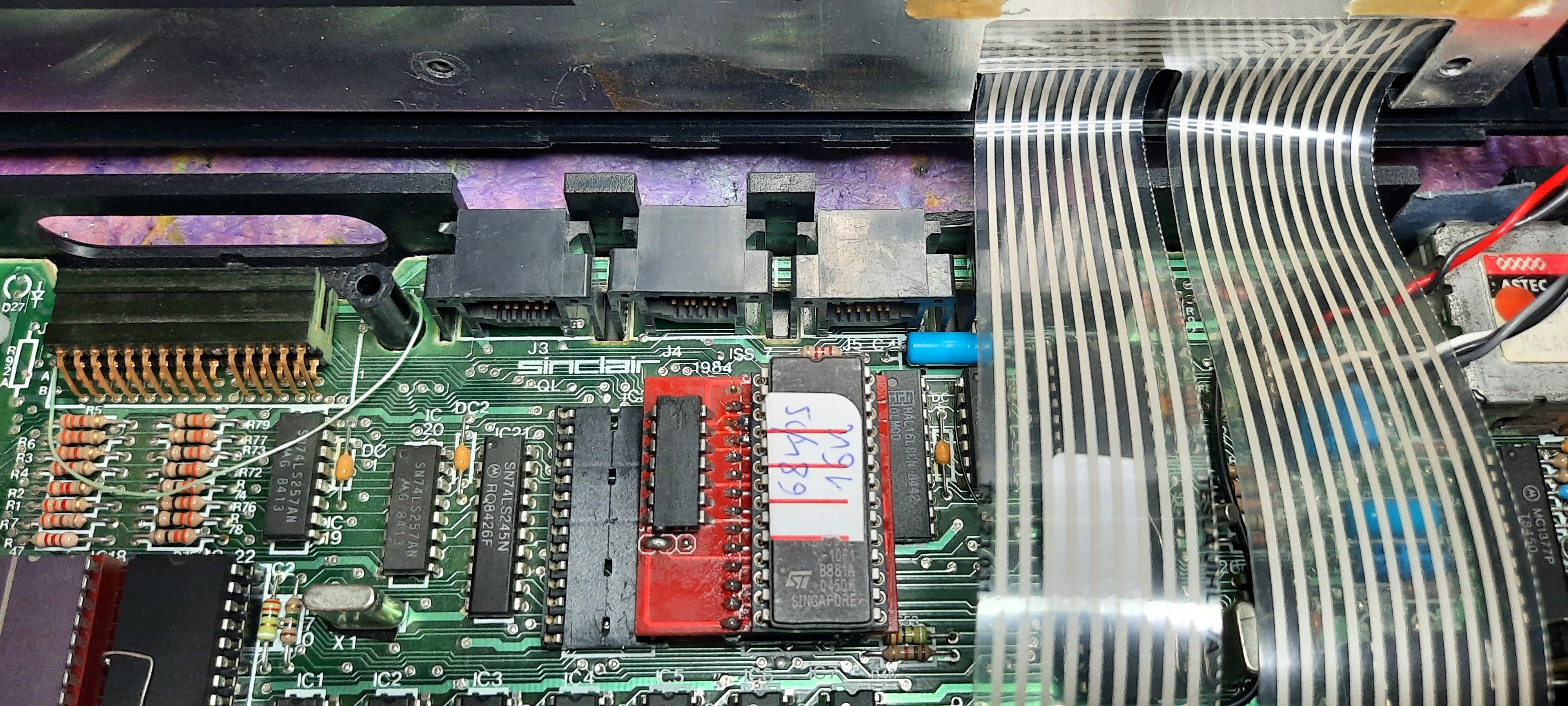

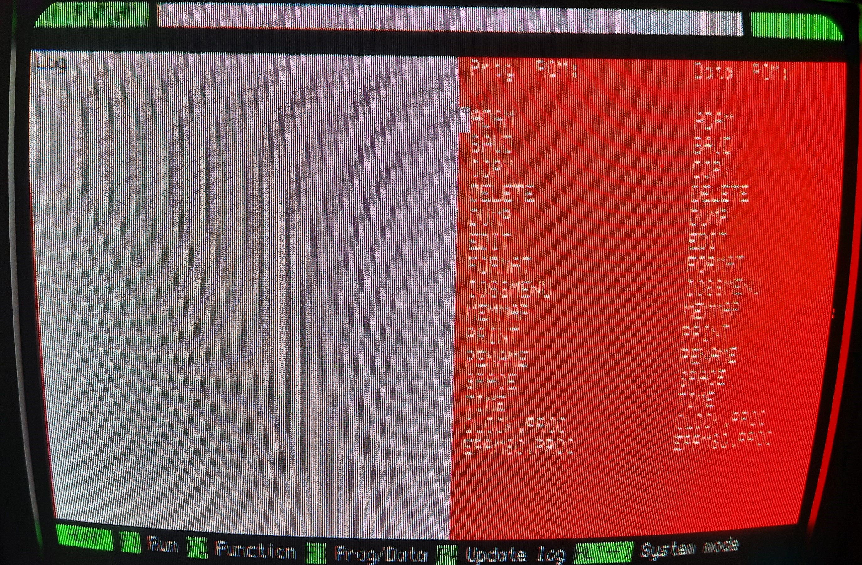

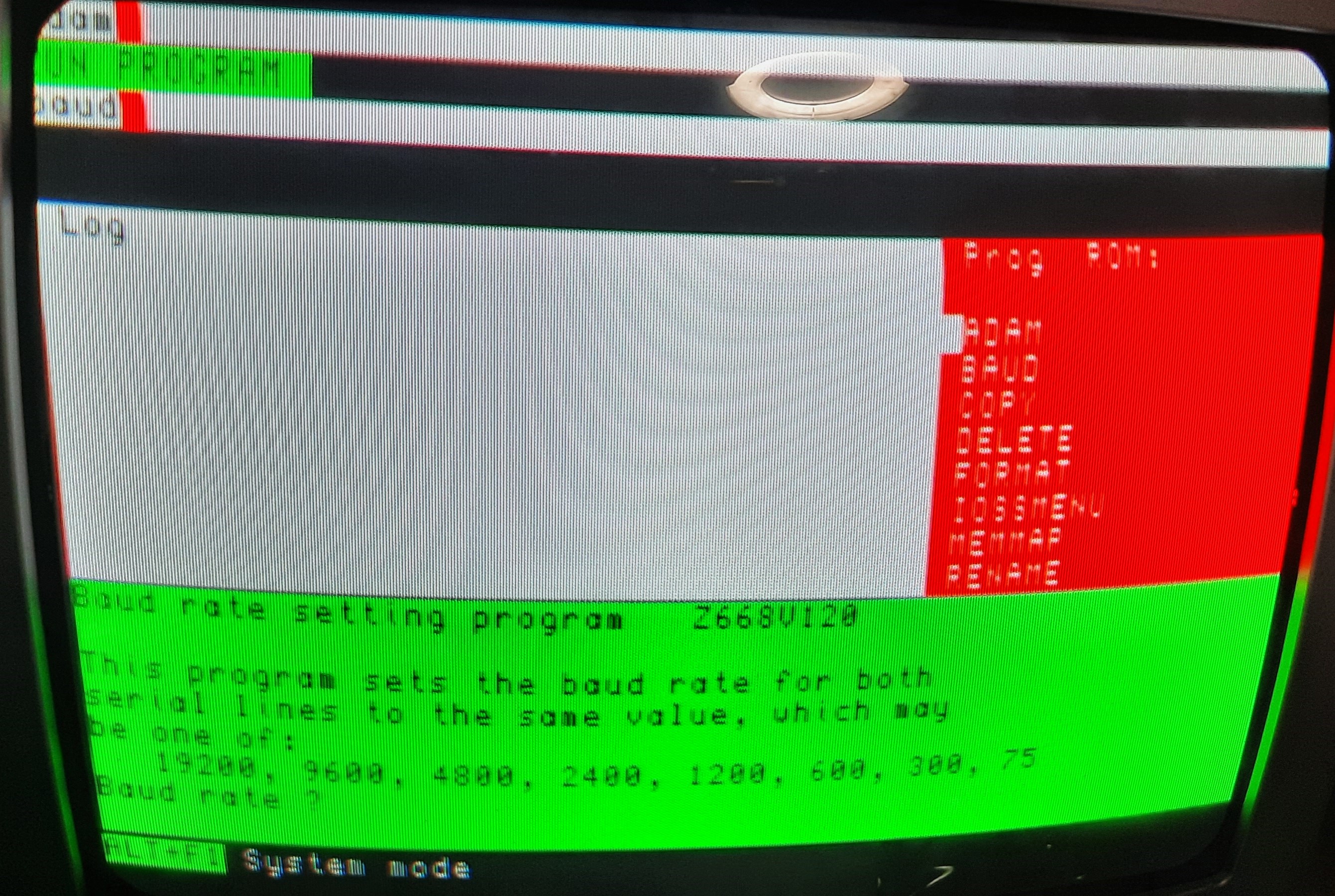

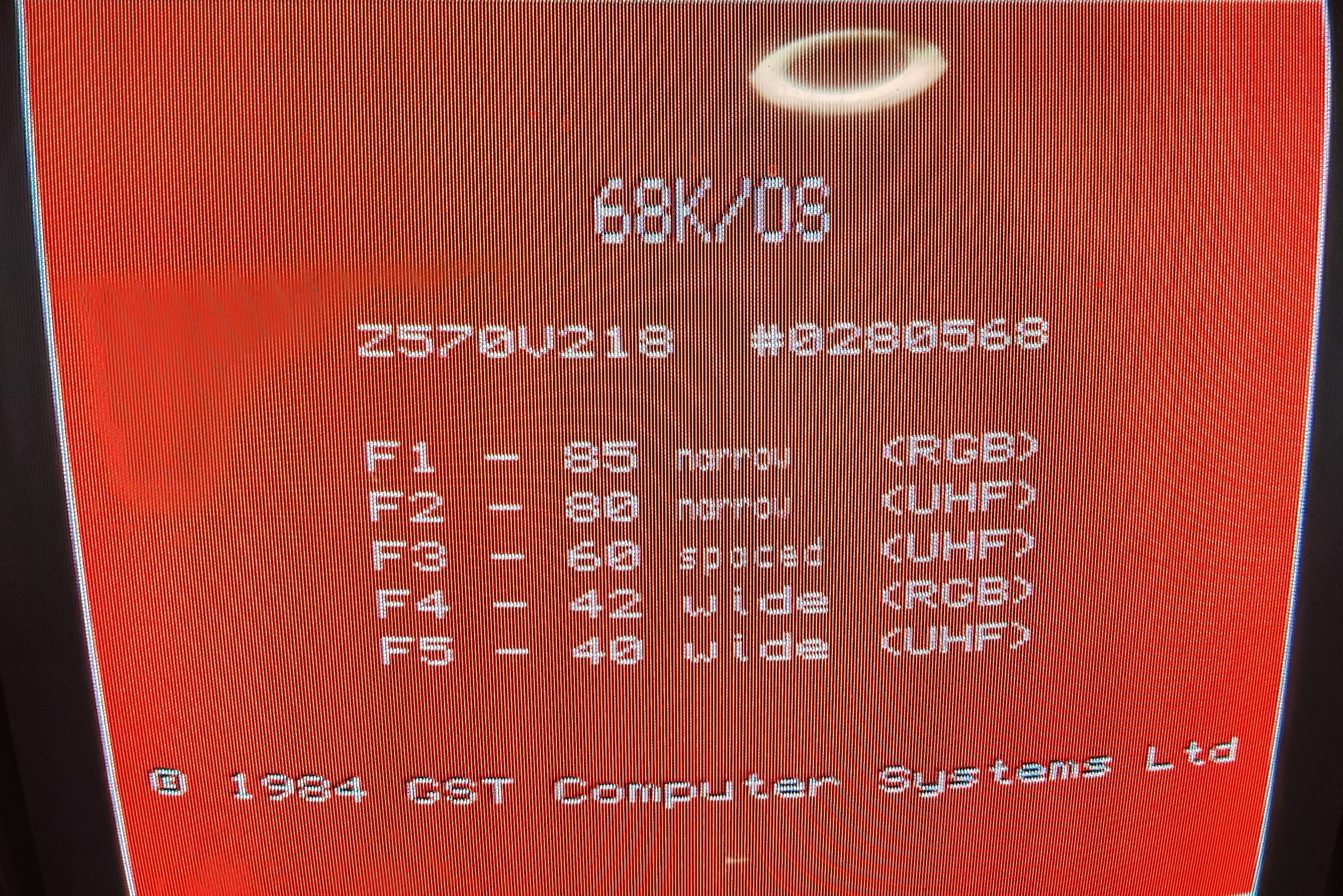

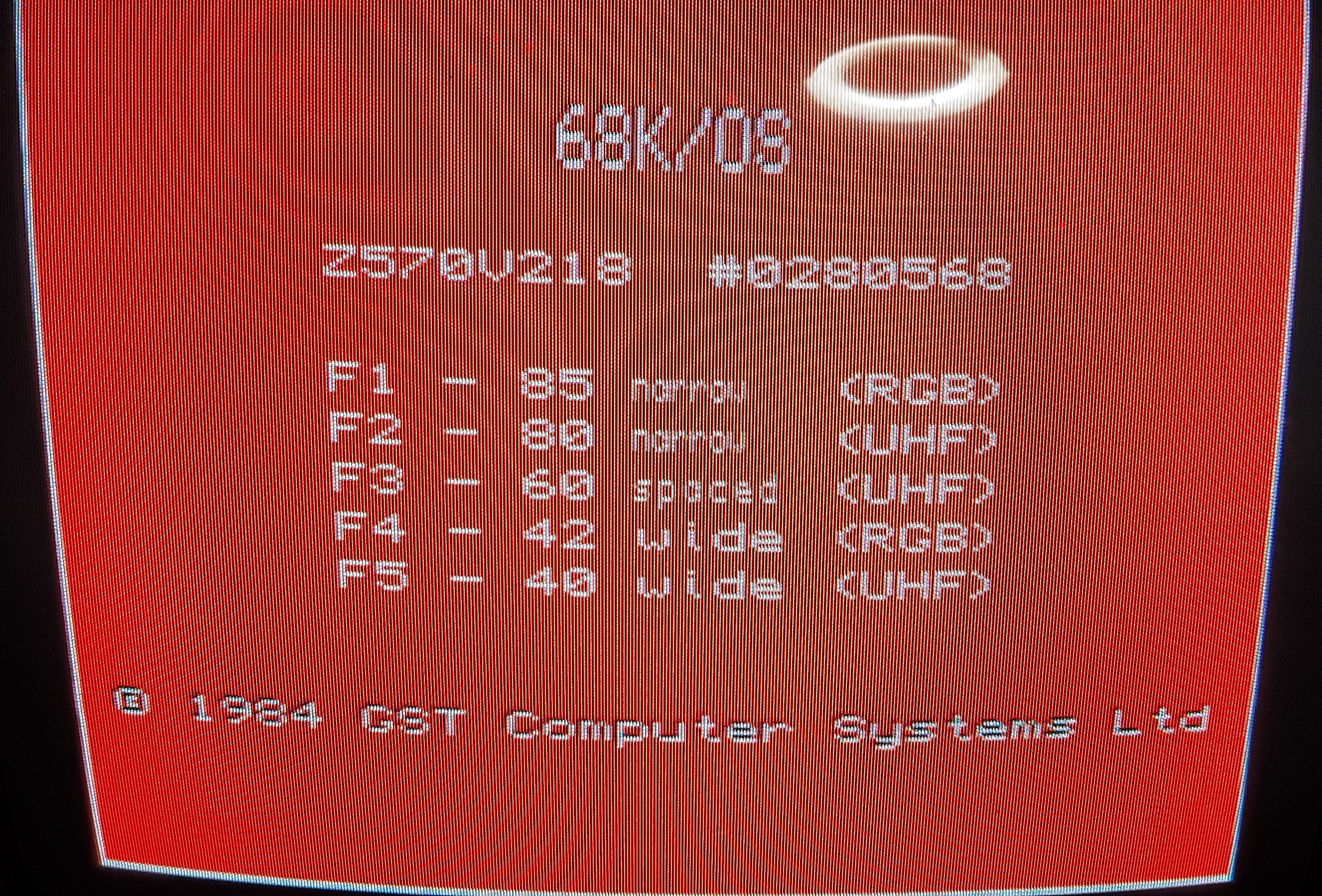

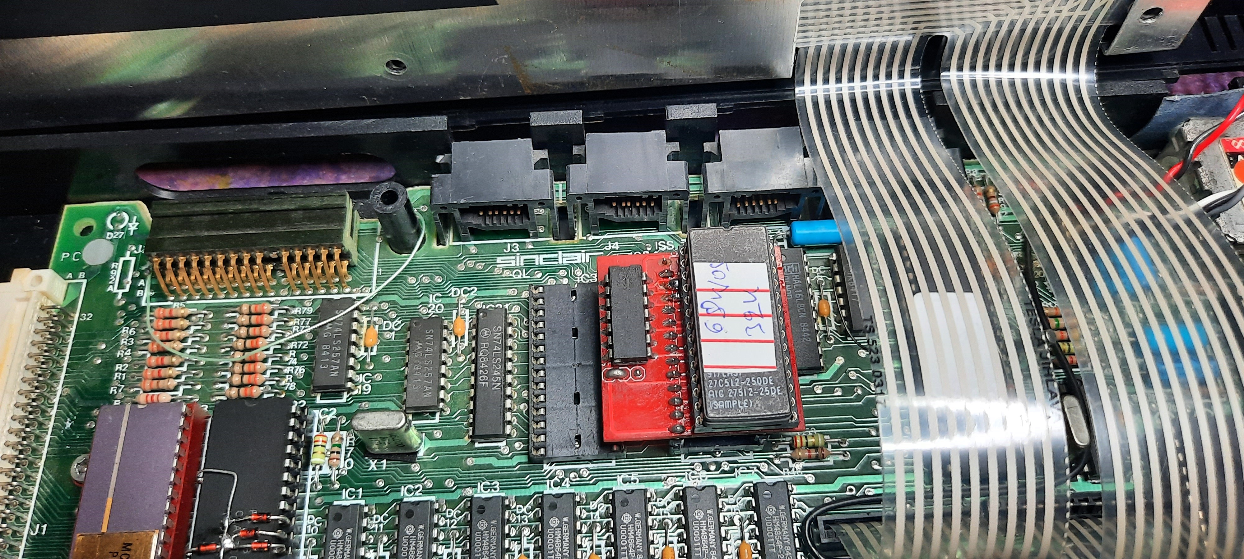

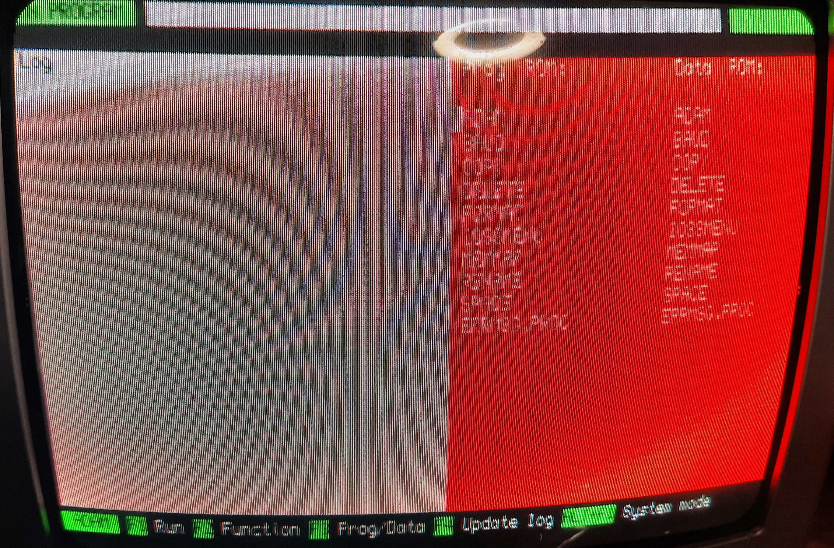

I was always intrigued to use the 68K/OS system but i never had the rom board. Reading this thread i decided to burn 27512 eproms and use theme on a minerva pcb adapter. So I programmed one 64kb eprom, first 32kb part at (0000hex) with OS bin file and the next 32kb part at (8000hex) with the Utils bin file. The only difference with the second eprom is that the utils bin file is the 16kb, programmed at C000. I don't know much how to use the OS, but i seems to run ok, as you can see at photos. I will try to mofify a rom port cartridge pcb, for use with 27512 eproms as Chr$ mentioned but it will take a while as the cartridge pcb has a different layout.

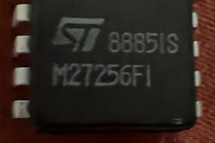

I tried to fit a 32K EPROM of the OS inside my test QL today (in place of JM ROMs), but all I get are black and white stripes (despite the eprom verifying multiple times)
Luckily when I re-fitted the GST 68K/OS card the QL was still working so I haven't damaged anything it seems
I obviously have more to learn about what EPROM's will work in a QL!
Could anyone explain to me, in laymen terms, why this 32K eprom is no good please? (I can use the 16K ST 27128AF1 EPROMs ok)

As per my previous post - the OE signal on the Eprom is active low - and on the QL PCB - and hence on the ROM socket - it's active high.
You will need to invert the signal with a transistor or a logic gate.
Easiest would be to use a BS170 mosfet - gate to the ROMOEH signal on the QL socket, Source connected to Ov, and the Drain connected to the OE pin on the Eprom and to a resistor of say 2K7 to 5v line - this ensures the chip is not selected when the ROM is not being accessed.
