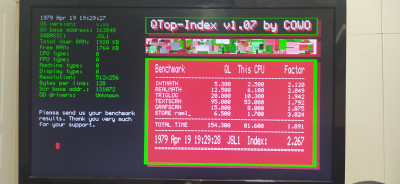

I did some optimizations in speed (10Mhz 68008 cpu)
Leon
Wow - more than double a stock QL - and still 8 bit wide - so this is all achieved through faster memory access and a faster CPU - 133% faster.

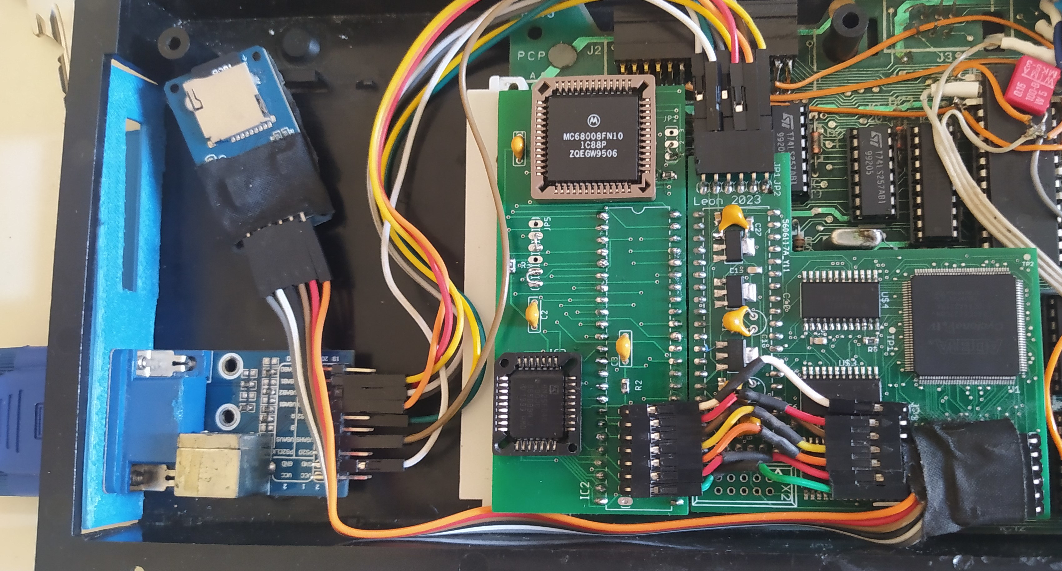

And with a little bigger fpga I can make it even a bit faster if I implement a true dual bus video memory and it will then be easier to make more graphics modes and also to implement a vga output. I'll try it, I hope soon.
Intel/Altera include small memory amount in their entry level fpgas and when you go for a bigger fpga for more sram with the same 144 pin package then you get less i/o pins so this is a problem. Maybe I'll have to try a BGA package in the future, Peter says it's easy to solder.
Anyway I think I found a good compromise between ram and io pins in a 144 pin package that will have all the features but will reduce the colors from 64 to 32+palette choice but will be a little faster and have a vga output and make easier to implement more graphics modes.
I'll add extra sound channels, a msec timer and potentially useful things like reading the current vertical line and I think that will be a good point to finalize the first version of the project.

I forgot to mention that I included a AM29F040 512K flash ic that currently holds the TK2 and QLSD driver, it can be mapped over the 2MB ram and reprogrammed easily with something like the TL866+plcc32 adapter.

Well the disk test makes the index a bit faster, I think it's more close to 2X, 100% faster that's not bad.Pr0f wrote: Tue Nov 14, 2023 8:18 am Wow - more than double a stock QL - and still 8 bit wide - so this is all achieved through faster memory access and a faster CPU - 133% faster.

here is a picture of my board:

I was just looking at the CPU clock speed - so 10/7.5 x 100 - so effectively 1.33 times quicker on CPU alone - which means the greater amount of the speed increase has come about through your memory access improvements.lliont wrote: Tue Nov 14, 2023 9:35 amWell the disk test makes the index a bit faster, I think it's more close to 2X, 100% faster that's not bad.Pr0f wrote: Tue Nov 14, 2023 8:18 am Wow - more than double a stock QL - and still 8 bit wide - so this is all achieved through faster memory access and a faster CPU - 133% faster.

You new new board looks great, if it is as good as the previous boards, I will want one.
To load SMSQ/E a Supergold card would be needed, but the Supergold card disables the 68000 so this looks like a new version of SMSQ/E, which might be harder than manual BGA soldering.
LOL, so QDOS and Minerva it will be with easy switching between them.Derek_Stewart wrote: Tue Nov 14, 2023 10:29 am To load SMSQ/E a Supergold card would be needed, but the Supergold card disables the 68000 so this looks like a new version of SMSQ/E, which might be harder than manual BGA soldering.
