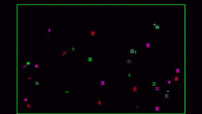

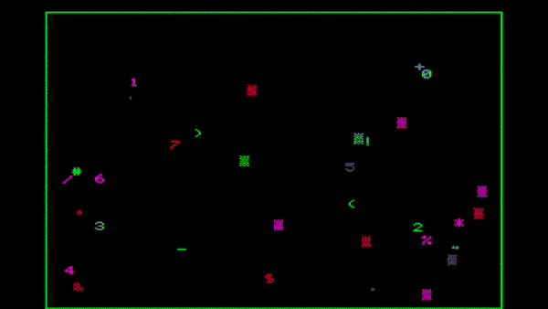

Hi Derek, Dilwyn and All,
Here is version5, which incorporates your requested modifications, tested ok under SMSQ/E in QPC2 and SGC.
Of course it halts under QDOS, because of the CURSOR# problem already discussed.
In high resolution, text CSIZES are best set to 3,1, as otherwise they are too small to identify. (In 800x600, circles are squashed).
I must work out how to adjust the bottom edge detection limit with big characters in high resolution too....
Thanks guys for the tips ! Regards, Steve.

Re: Doodle
Thank you Mark. Looks like you've already done some of the things I was hoping to do to adapt the program to what I want to do with it.

Re: Doodle
Hi Dilwyn, Derek, Mark and All,
Thanks guys for your helpful comments tweaks and suggestions.
Therefore I have ammended the code and also optimised it still further, to reduce shuddering.
SGC needed Mode 8. No more checkered characters. Hit ranges are now progressive.
(ESC)ape or (N)ext screen keys added. Line 150 p=1 to 8 page sizes ; 250 Q is number of sprites.
The whole program is now faster and smoother. Tested ok on QPC2 & SGC under SMSQ/E.
Regards, Steve.
Regards, Steve.

- Aurora
- Posts: 890
Re: Doodle
Hi again All,
The final version caters for monochrome screens. Let 450 be RND(1 to 7) for MODE 8 colour.
Let 260 be CSIZE 0,0 & 220 th=5 for longer animations.
Modify lines to read wd/2 or hg/2 (or whatever) to reduce screen sizes.
SCALE must be hg,0,0 under QDOS, (due to a system bug), ELSE where under SMSQ/E....
Enjoy experimenting ! Steve.
