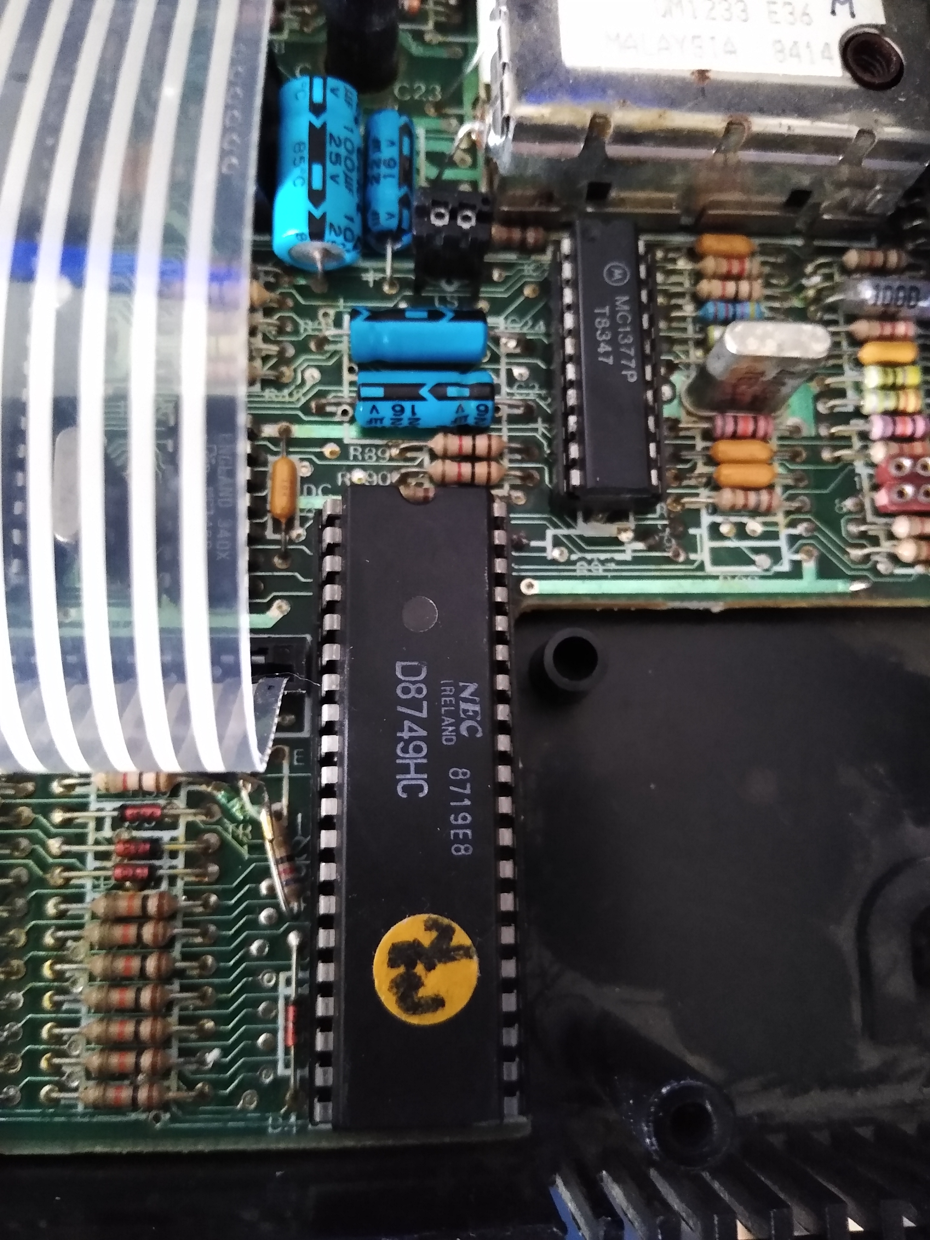

I have been repairing a QL board, which is now working. It has a NEC D8749HC installed see picture below:
According to the Hermes manual, this means it is non-Hermes.
I am assuming the NEC D8749HC emulates the 8049 and is not updatable.
Which the Hemes function IPCVER$ returns 0.0According to the Hermes manual, this means it is non-Hermes.
Re: Hermes status
That's intriguing, it's dated 1987 so may have been programmed by user (8749HC windowless One Time Program chip). But why not just use 8049 that came with QL?, perhaps modified for some reason (my Schon IPC variation was 8049). Be interesting if you can get binary dump and see if it differs from known code.

Hi,Silvester wrote:That's intriguing, it's dated 1987 so may have been programmed by user (8749HC windowless One Time Program chip). But why not just use 8049 that came with QL?, perhaps modified for some reason (my Schon IPC variation was 8049). Be interesting if you can get binary dump and see if it differs from known code.
Here is a binary image of the NEC D8749HC

I do not think there is a 8049 binary file, my ALL03A programmer does not have a 8049 entry in the software, but the NEC D8749H entry reads the 8049 IPC. On saying that the NEC D8749HC reports IPCVER$ as 0.0 which is a non-Hermes IPC.

I did a quick compare of your 8749 code & the Hermes22 dump and I can't see anything that matches but since it only takes a one byte move to change all the addresses etc it would probably require a lot of study to find bits that do the same job with different numbers.

The 8049 should be readable using 8049/8749 using the HiLo programmer.
However there is an IPC project on GitHub I think, which has a binary file with it.
I compared that with the one Derek put up on the thread - and for the most part it would seem to be the same source, but there is an additional block of code and some earlier addresses are changed (probably jumps with changed addresses) - ignore the message about length - the one from github doesn't have the trailing zero's to make the file 2K in size - but I have checked with hed editor and the file from Derek is all 0's from the last code location on to the end of the 2K image.
These are the changed locations:
00000283: B4 D4 - original IPC code: 0283: B4 C8 CALL $5C8 scan keyboard, entry A (one bit=1), ret A
00000507: B4 D4 - originalIPC code: 0507: B4 C8 CALL $5C8 scan keyboard, entry A (one bit=1), ret A
0000052D: B4 D4 - original IPC code: 052D: B4 C8 CALL $5C8 scan keyboard, entry A (one bit=1), ret A
000005CC: 00 C4
000005CD: 00 80
C480 are 2 new bytes in this routine:
; scan keyboard, entry A (one bit=1), ret A
05C8: 39 OUTL P1,A output A on P1
05C9: AB MOV R3,A
05CA: 80 MOVX A,@R0 put P0 in read mode=HI-Z ??
05CB: 00 NOP wait a bit
05CC: 00 NOP
05CD: 00 NOP
05CE: 00 NOP
05CF: 00 NOP
05D0: 00 NOP
05D1: 08 IN A,P0 get P0 into A
05D2: 93 RETR
And there is all new code from 680 onwards to 6D3, which I presume is linked from the changes above.
It looks as if the changes are all related to keyboard workings.

Don't you see something in 07F1H?Pr0f wrote:I have checked with hed editor and the file from Derek is all 0's from the last code location on to the end of the 2K image.
Re: Hermes status
you are right - 07 hex is there - I missed that.Ruptor wrote:Don't you see something in 07F1H?Pr0f wrote:I have checked with hed editor and the file from Derek is all 0's from the last code location on to the end of the 2K image.
