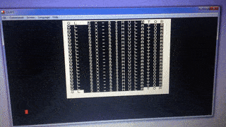

So I ran my BANNER_BAS demo program in QLAY2 with its speed set at 5,000 and delay at 30 and this is what I got. I created an animated GIF to reduce the size from the movie file (plus optimized it which makes it look a little grainier).
It is cycling through a square pattern normal and then inverted, followed by a spiral pattern, normal and then inverted, and repeats. That would take a little over 3 minutes on a BBQL running ZXSimultor and about 2 minutes on a ZX81.
With QLAY2 speed at 10,000 with 0 delay it just flashes...I had posted the GIF but it's too annoying on the eyes so I removed it.
I think the BANNER_BAS demo looks best with QLAY2 speed set at 1000 and delay at 120 as you can follow the spiral patter a bit more easily...the GIF would just be too big to show here.

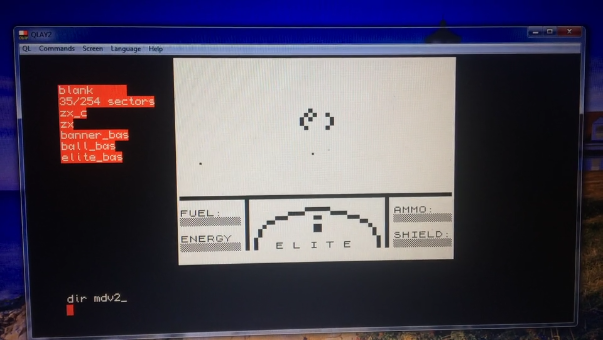

Current version of Elite for the ZXSimulator that goes with the latest version (above):
This version has moving stars and an enemy ship. No logic yet for moving left/right/up/down and/or shooting at the ship (that's next). Then adding a planet, maybe a space station w/docking and some bartering. We will see how far I can take the demo. I think my linear search for line numbers will start impeding and will need to be changed to a binary search in the BASIC interpreter (or course running on a QL in accelerated mode makes that a non-issue).
Note this was written in the ZXSimulator though I've been using it in QLAY2 running a bit faster than the unexpanded QL but it could be written on an unexpaned QL and the experience is far better than the original ZX81. One feature I may add in the end is a renumber features because its'a pain to do it by hand.

bwinkel67 wrote:New version. Nothing major for the ZXSimulator, just a small bug fix where INPUT A$ for the string it included the new-line character and so now it doesn't. I did update the Elite.bas game and now it has a the ability to move up/down/left/right and fire at the enemy ship and eventually kill it (animated explosion and all). You can also redefine the key bindings for the game in configuration window (default is F for fire and A/D/W/S for movement).
It plays ok on an accelerated QL within ZXSimulator but is hard to play on an unexpanded QL or ZX81. I think I will change it to have the up/down/left/right controls remember the last position so you don't have to keep pressing the appropriate key and checking the INKEY$ each time to move (i.e. the control stick will not go back to zero). That should make it more playable. Then I can add some display elements and see if planets and commerce can be included. It will be much simpler than the real Elite game but it is just for demo purposes.
After all that I decided to change the Elite demo to make it more playable. This one keeps cursor state info so if you move to the left it keeps moving until you move to the right. It also has filled out the display a bit more and shows which direction you are moving and has stubbed out the other areas though they are not yet functional. Still slow on the ZXSimulator (and an actual ZX81) but the actual Elite game wasn't about fast paced action anyways (at least the C64 versoin).
Including the ZXSimulator zip file since it contains it plus .p and code dump so you can see what I did.

Posts: 1604
Re: ZXSimulator
Here'ss a video of Elite playing on ZXSimulator (accelerated, not unexpanded QL): https://vimeo.com/408952080
And here's a screen shot:
