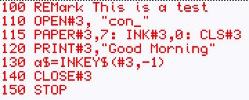

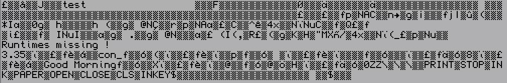

To clarify it: The namelist in an _obj program just contain the commands/keywords, which are used in this program and the sequence is independently from the usage in the program. It is of course possible that it is the sequence in the OS:
