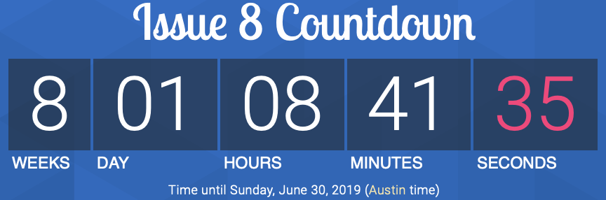

Derek_Stewart wrote:Okay, back on topic when is the Issue 8 board going be available.
This is my self-imposed deadline. I hope to make it. July is a good bet unless something goes horribly wrong.
