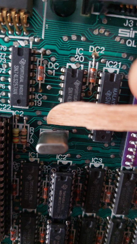

After getting axial capacitors, sockets for RAM and xtal X1 from China... long wait :)
I got a new doubt...
Often there are some thumbs on boards for oscillators or xtals that have a pin for GND... well... it happens to me that in some ZX boards when I connected them to this pin the system stop working, also in Commodore Amiga 500, so I shouldn't connect those Xtals to GND... but here we go... Issue6 replica had this pin connected to GND and I have no idea if I should connect the chassis to GND or not...
Here is a picture to illustrate the question:
Should I connect chassis to GND?

after trying to document about when should a chassis oscilator be connected to GND or not... I got the answer for this particular case...
The answer is... DO NOT CONNECT!!! anyway! never XD
They were careful about and placed a piece of plastic between the oscillator and GND as it is shown in my Issue 5 board.

For the crystals - I use a small air gap and then a blob of silicon or glue just under it, but avoiding the pads for the 2 crystal contacts - or if I have spare ones - the plastic spacers.
It's a good idea to have the crystal mechanically solid on the pcb and not rely on the leads to support it on their own. It also stops any possibility of the crystal acting like a microphone.

Pr0f wrote: Fri Aug 18, 2023 8:58 pm For the crystals - I use a small air gap and then a blob of silicon or glue just under it, but avoiding the pads for the 2 crystal contacts - or if I have spare ones - the plastic spacers.
Good idea...
plastic seems great, sometimes I use this layer that women use for nails. Do you know what I mean? with acetone that is easy to remove if needed. But... plastic... so nice and easy.
