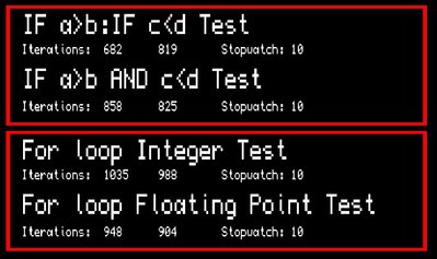

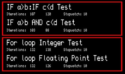

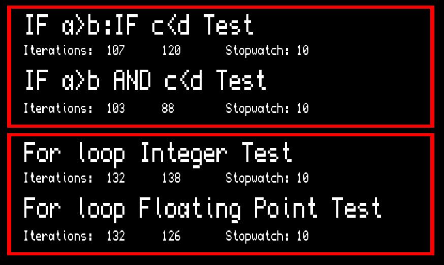

OK - here are my results.
I used the QL + Tetroid's GoldCard and QEmulator set to QL speed and then to GoldCard speed
The only conclusions I have are:
- QEmulator set to GoldCard speed is about twice as fast as the QL with GoldCard !
- after running the program several tiemes = on QEmulator on the first run of each test (the first 5 seconds) the results can vary with as much as 20% - the second run (next 5 seconds) the results are more consistent, the variation is 5%
- on QL+Goldcard the results vary with only 1% or less
- the construction IF a>b AND c<d Test always had more iterations than the double IF
- the "For loop Integer Test" always had more iterations than the floating point (but I guess that this is because integer addition is faster than fp addition, not because of the for loop)

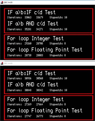

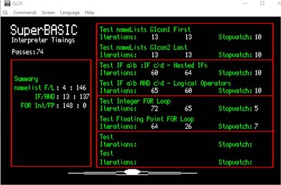

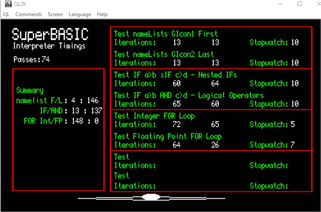

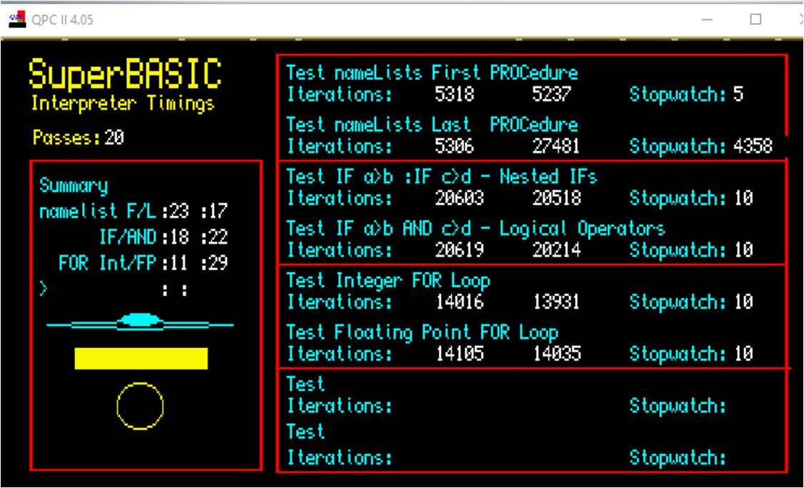

Re: QL Tinkering

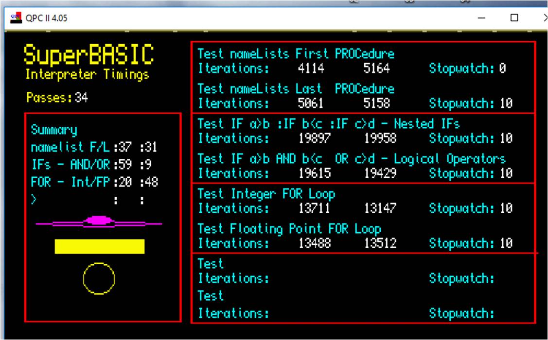

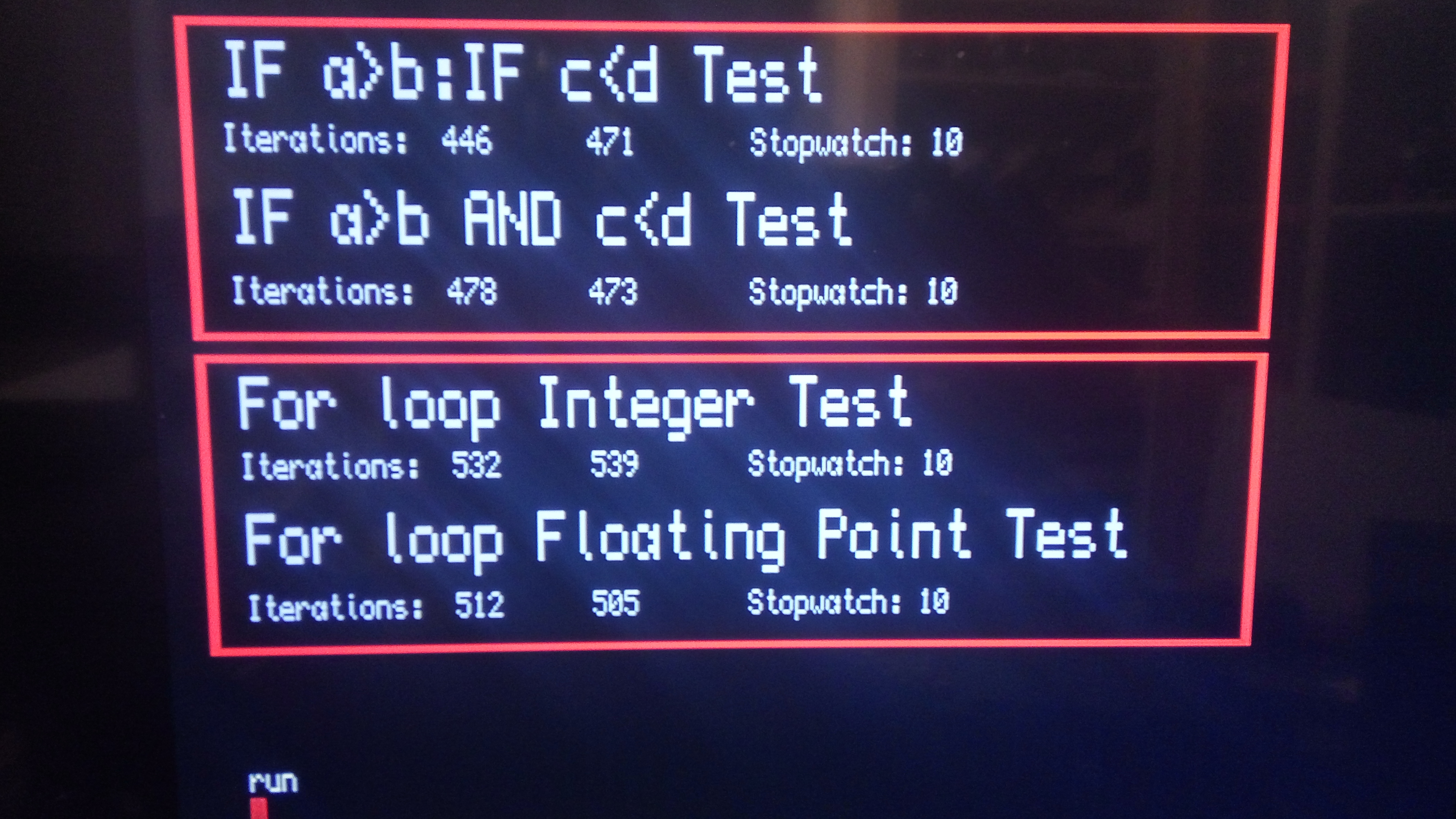

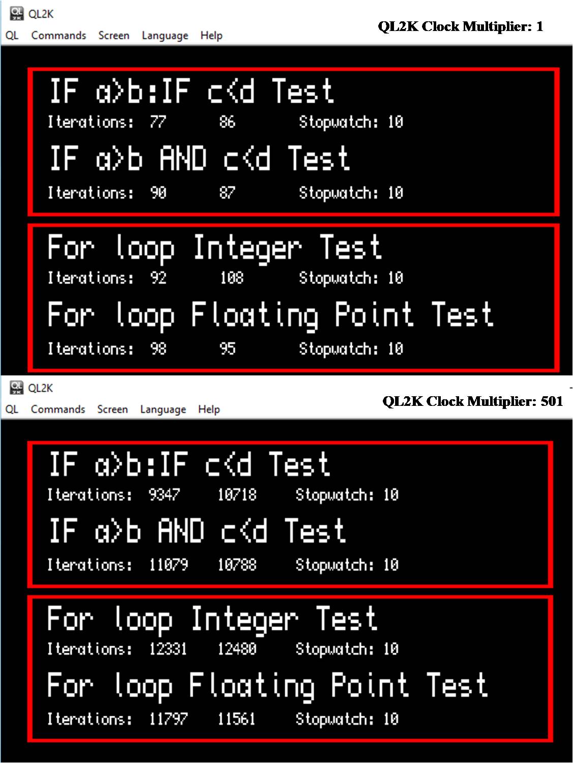

Hi, 23 Sep 2018
Thanks Andrew for posting your results..and M68008 I take note and understand you point of relevance to different builds. SELect ON pjw I have left a section open in my updated Prog just for such...
Updated Prog... see attached.
The checks carried out so far do not appear to give the results I was half expecting. I note that my tests are run on emulators not hardware. For the namelists First/Last entry in some of the tests came out heavily in favour of the Last not First. The nested IFs as opposed to the logical operators when like for like the results were often about even. When the number of false expressions increased the nested IFs were constantly ahead (as you would expect).
The FOR loop identifier I have since learnt always uses a simple Floating Point variable name. As to FOR loops with Integer variables being faster than Floating Point variables the results in most cases for the QPC2 emulator appear to favour the FP. The QL2K emulator running at singles clock multiplier speed (ie original QL speed) implies FOR loop with Integer variables are faster.
SBTrials01.jpg was run with nested IFs / Logical operators where all expressions are true
SBTrials02.jpg was run with nested IFs / Logical operators where only the first expression is true
SBTrials03.jpg QL2K emulator clock multiplier x1
QBITS

Re: QL Tinkering
Hi qbits,
Integer FOR loops are faster than FP ones if you Turbo them. (The Turbo manual is full of good tips on fast coding tricks).
I find timings using an emulator are not consistant, as they are on QL hardware, because of PC overheads.
Timings on QLs are slower than on emulators, but can be scaled so as to be relatively meaningful.
If you want maximum speed, code in C++.
If you want user-friendly coding, use your QL or emulator... as you will write and debug code much faster !
As a general rule in Industry, don't take more time coding than will be saved by using that new code.
But as tinkerers, we may just enjoy coding for fun...
QL Forever !
Steve.
QL Forever !
Steve.

The SELect ON where the identifying variable is a Floating Point variable, gives a wide choice of options. In evaluating an expression using an Inline form SELect a=65,97:PRINT ‘Aa’ is very similar to IF x=65 OR a=97:PRINT’Aa’.
One of the requirements in Games is checking if a boundary has been reached or the limitations of the area surrounding a target that qualifies as a hit. In either case the limits can be described as xmin, xmax, ymin, ymax. Here the use of the SELect command as an alternative can be compared with nested IF clauses and IF combination Logic operator clauses:-
IF x>xmin: IF x<xmax: IF y>ymin: IF y<ymax:PRINT ‘Home’
IF x>xmin AND x<xmax AND y>ymin AND y<ymax:PRINT ‘Home’
SELect ON x
=xmin TO xmax:SELect On y=ymin TO ymax:PRINT ‘Home’
END SEL
Observations after 10 passes on the QPC2 Emulator for each set of comparisons when x,y are True (ie. fall within the boundaries), nested IFs clauses and If clauses using Logical operators are about even but SELect scores higher against both. When x,y both fall outside the boundary area ie. all expressions are False, nested IFs score consistently higher than Logical operators, but surprisingly SELect still out performs them both.
Further upgrades to my Prog SBTrials...
