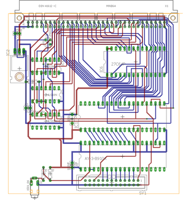

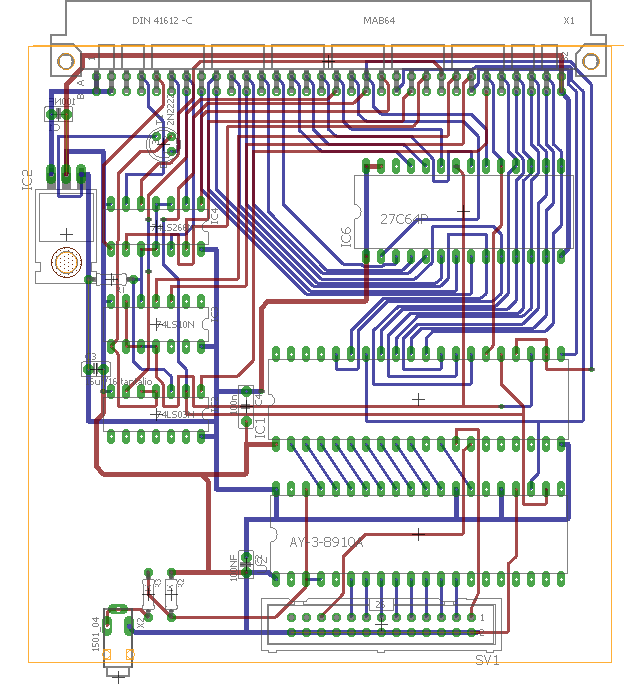

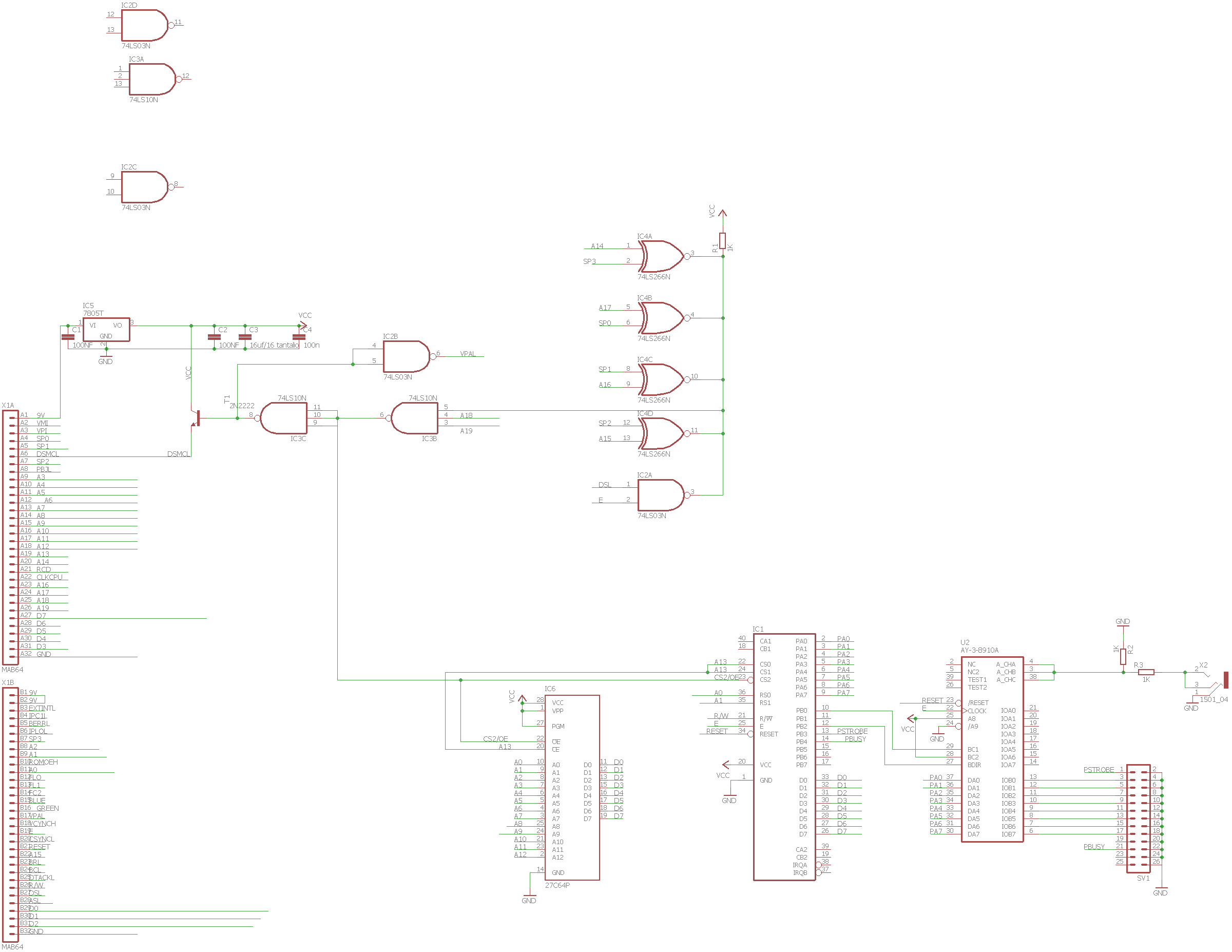

I have been using Ki-Cad to draw the schematic, which I have made the AY-3-8910 part for the schematic drawings.
The updated drawing from Silvester will help with finishing the schematic work.
I am more interested in repairing the PCB, but the person lent the board seems to ignore my messages asking if I can have board returned.
So I will finish the schematic based on information received and photographs.

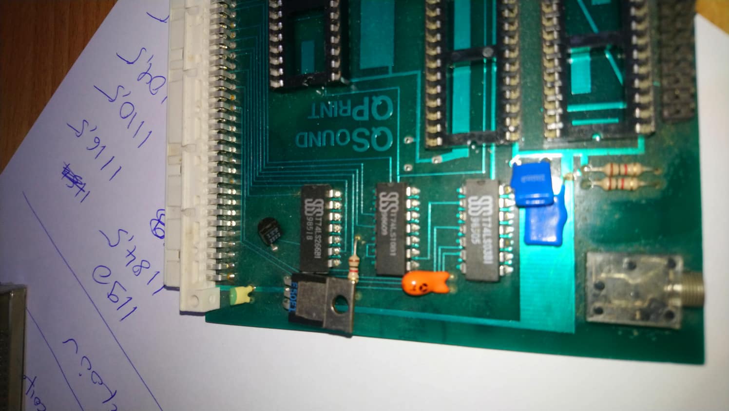

Hi all,
I currently visit my parents and went to the loft. As expected I found my QSound QPrint board. I never used it and I have currently no QL system running. So I can not check whether its working. But I can help with all missing information. I did not read to all the thread but as I remember still missing:
1. Transistor is ITT 2222
2. capacitor close to 5v regulator is 10n
What information else do you need?
Best regards
Stephan
Best regards
Stephan

I see, no more information from my side needed
Will return it to the loft.
