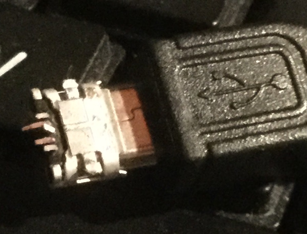

I'd love to try out the QL core on my MiST. But unfortunately it's broken.
The tiny USB Port ist torn apart the mainboard. I was always careful, but
I killed it. :cry:

Baert wrote:I'd love to try out the QL core on my MiST. But unfortunately it's broken.
I killed it. :cry:
I would go back to the supplier and explain there was an accident, they may repair the board.

Baert wrote:Yes, I know the DC Power Jack mod. But I have in mind to
install a new and more reliable USB connection.
Btw: Lotharek sends no invoice!
I would do the DC Power Jack mod, the mini USB socket looks too flimsy.
The surface mounted pads that have been been torn off the board should be repairable. Try posting photograph, there maybe advice available.

Post by Baert »
I didn't open the case yet. Therefore I only have this picture...
Best regards,
Baert

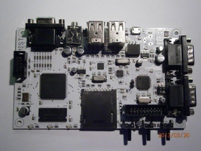

Here is a picture of the MIST board:
MIST Board
MIST Board
It looks like you have ripped the micro USB connector off the board, the electrical connection are surface mounted, so could be wired up to the original connector or new connector mounted elsewhere.
