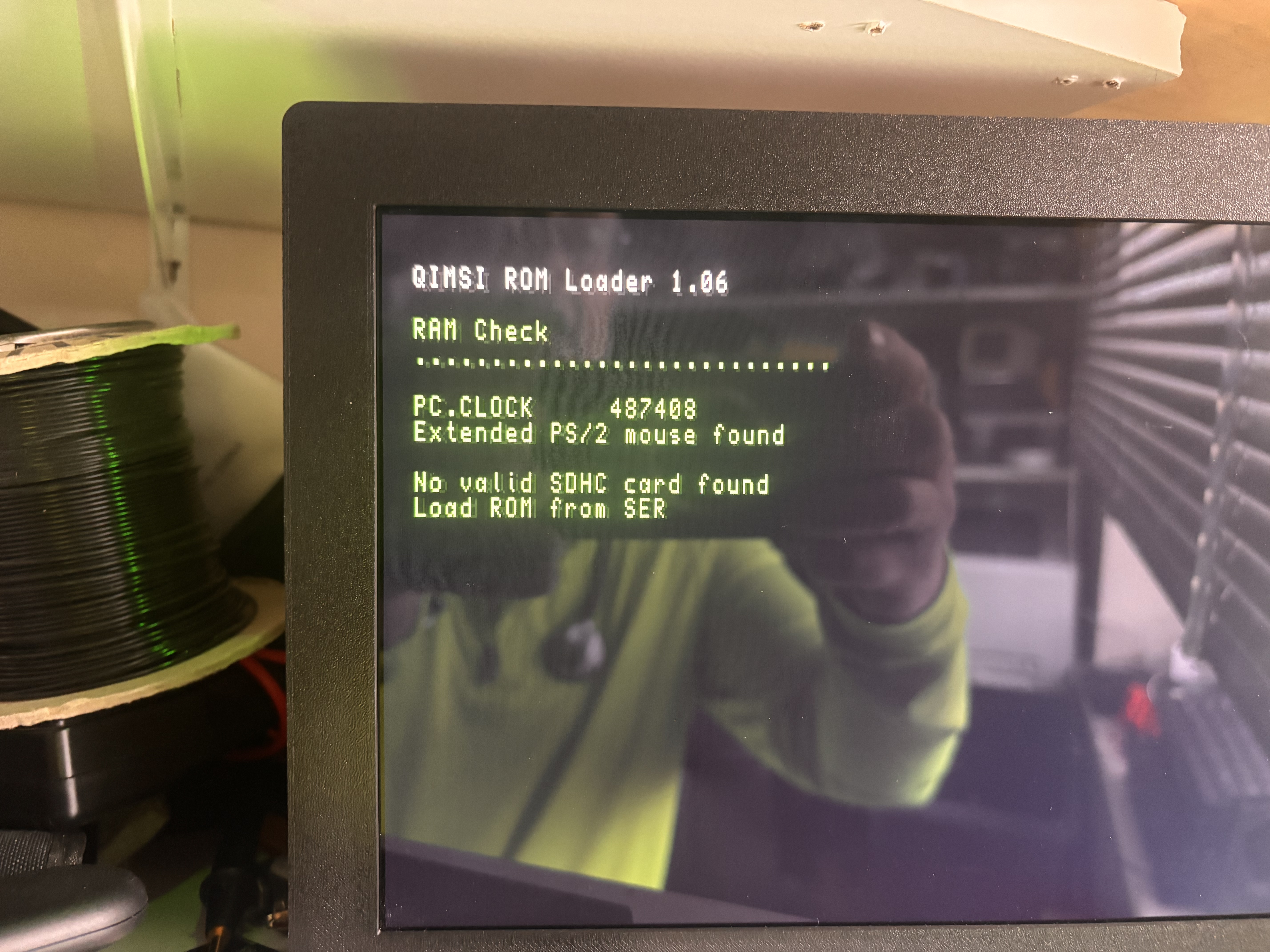

Good news, the Cherry mouse has arrived and works great on the original, repaired USB micro connection. So my repair worked perfectly but none of my previous mice (about 10 various makes and connection types) work. The mouse works a treat without any drivers installed with the “lrun win8_boot” program from the default .WIN container. I can now on and learn more.
Thanks for all you help and patience.

ROM 3 is initially located at $0 (4K) and $19000 (12K) of the accelerated CPU and does things like RAM check, initialization of mouse, RTC, SDHC card and loading the OS from serial port or card. It will usually overwrite itself at $0 by an OS ROM and replace $19000 with RAM when finished.
