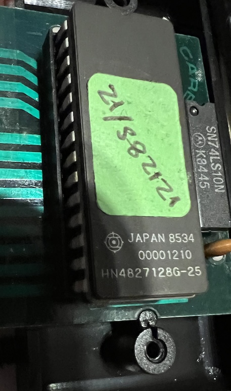

But in the meantime I have an ICE ROM cartridge with a socketed EPROM and I'm wondering if I can make use of this board (not the eprom) for various experiments as I learn more about the QL hardware?
It's a 16K EPROM so am I correct in thinking I can just replace the EPROM with one of my own 16K eproms please?

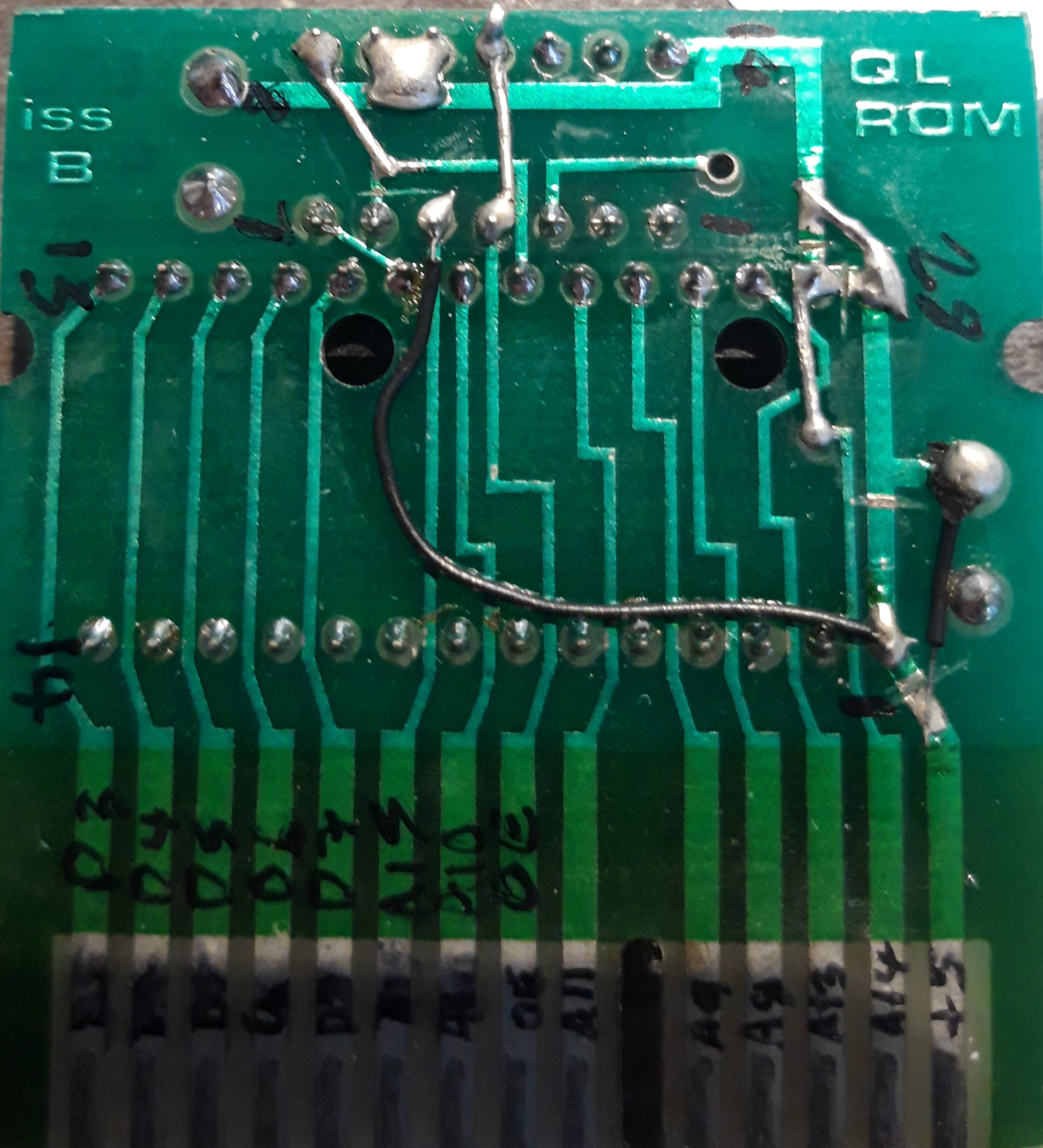

Yes, you can and whatever is put on that 16k EPROM will appear at C000h, but there will be no way to disable it in case anything else also tries to utilise that area of ROM. You can also modify those boards to take a 64k 27C512 chip and replace the entire internal ROM(s) and have the C000h area for whatever you want.
It looks like this:
Hopefully you can see the cut traces etc.

Pr0f wrote: Tue Jun 04, 2024 10:35 pm would be handy to design a ROM port plugin cartidge with a switch or jumpers and a ZIF socket - for just such experiments :-)
I did, but when I ordered a few slot connectors of the right size (as a passthrough for QIMSI) they never came! They don't seem to be available in the right size and I haven't yet looked into buying longer ones to cut up.... was going to modify a PC ISA slot connector to experiment with.

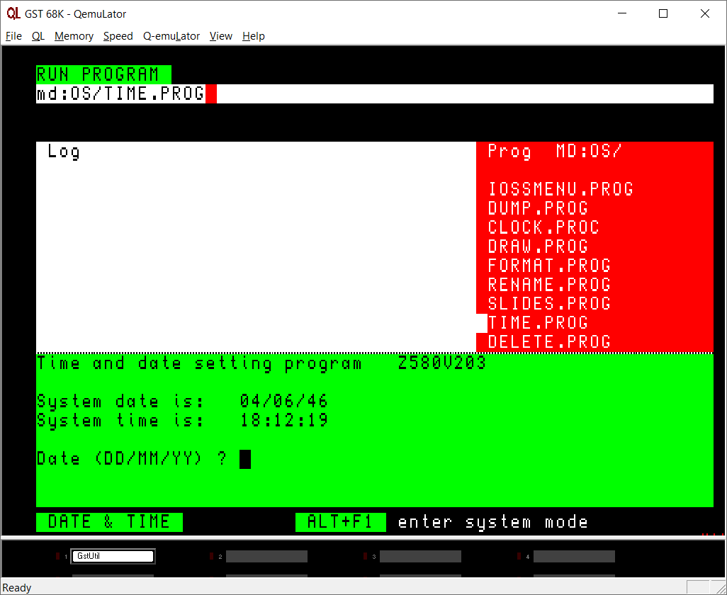

t0nyt wrote: Sun Jun 02, 2024 6:02 pm You can't do anything that needs the Microdrives as Q-emuLator doesn't support the 68K/OS MD format yet (but I believe Daniele is working on that from a logic capture of my drive)
Yes, I have a prototype that allows 68K/OS to access the microdrive:
Still thinking about the mdv image format, it's ... complicated.
I've also noticed that the ICL OPD microdrive cartridges have a sub-byte space between block header and sector data, so I wonder whether a byte-based representation would work well for them.
