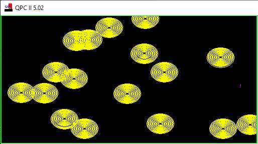

I'm not sure if it's just because Brownien3_bas is faster or what, I now get all sorts of problems when it runs.
On QPC2, this is what happens at startup.
See picture, it instantly more or less fills the screen with yellow explosion circles and not a lot else happens. Not sure if this is because it's so fast that rapid multiple collisions are inevitable or of something else is going on. It's hard to tell from the speed of things, it looks like there are multiple 'explosions' to start with, then things start moving normally with whatever is left. Subjectively, seems to be a lot more flicker in Brownien3_bas when things are moving around. Probably down to the differences in speed between my PC and yours?
On Q68: Oh dear, slower than ever now. Unusable. Can't immediately see anything obvious causing this.
I'm going to tinker with the code over the coming days to see if I can see what's happening, e.g. in case I have an extension installed with the same name as a variable you use or some such something causing problems.

Hi Dilwyn,
Looks like I sent the wrong version 3.... after testing on SGC and QDOS, whilst tweaking to adapt to both them and QPC2.
Version4 is rewritten and should run much faster still, but be more stable on all three systems now.
I will have to slug it somehow, as with just a few sprites speed is blistering on QPC2! (And yes many collisions occur at first).
When Turbo'ed, speed on SGC is improved too, that is if you limit the Q variable to say 8 sprites.
Please fell free to tweak as you wish... I hope to achieve a final version soon, with all variables LOCALised for other systems.
Regards, Steve.
Regards, Steve.

Thanks Steve. That works a lot better. Can't believe the speed running on QPC2. I'm not sure if it's me, does it actually slow down and flicker more as the number of objects on-screen decreases? I'll need to spend more time trying it out tomorrow.

Dilwyn,
The more sprites there are initialised, the slower the program effectively runs.
But with say, Q=170 sprites, as less sprites remain after collisions, then an illusion of empty sluggishness appears...
Do slug the program on QPC using line 705 pause 5, but not on SGC... as it will become too slow.
ADD to the drawem procedure : LOCAL loop,n,x,y,z,af,df,k and the version should run ok on other systems ?
Regards, Steve.
Regards, Steve.
