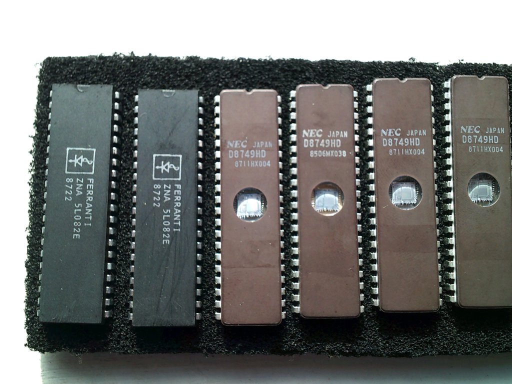

Damn! I could potentially have picked up thousands of these back in the 1990's. BT used 8749 as controller on their 30-channel PCM cards. Just before I left I scavenged a dozen of the cards thrown in a skip. They also used Ferranti ULAs - never found any info on them though.

I have about 10 in my stock...Silvester wrote:Damn! I could potentially have picked up thousands of these back in the 1990's. BT used 8749 as controller on their 30-channel PCM cards. Just before I left I scavenged a dozen of the cards thrown in a skip. They also used Ferranti ULAs - never found any info on them though.
May be worth having a poll to see how many 8749's might be wanted?
Regarding ULAs, these are customized anyway so you would not be able to find data except perhaps a 'high level' block diagram in some service manual for those cards.
I think NEC did OTP (one time programmable plastic case) 8749, and also a 44-pin PLCC version. The problem with either, as with any OTP part that has long been out of production is that they come from the surplus market and may have already been programmed for some purpose but never used, and hence became surplus.

I have managed to programme: Intel D8749H, NEC uPD8749HD and tested okay on a QL.
So it looks like the Hermes v2.2 rom code an the HiLo Systems ALL03A programmer can programme the Hermes chips.
I can provide this programming service, assuming the 8749 are available.
I also can provide the Hermes floppy disk and reprint of manual.
