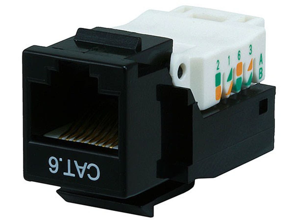

In either case, a nice matching ABS printed cover would be available for those looking to secure/protect their (S)GC. One idea is to use a short single ended ethernet cable to the socket, and the other end going to a CAT5 keystone molded into the case. https://www.monoprice.com/product?p_id=1039
