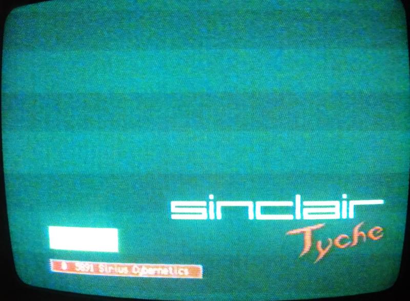

Maybe it doesn't work. Having put it back together I get this screen and in the white box it says press F1 for TV or F2 for monitor but it doesn't do anything with either key so does it mean my keys are not working?
Posts: 1564
Re: Issue 6 VM12 & resistors confusion
a fracture in the keyboard tails is one of the most common 'failures - particularly if you've had the lid off a few times, - it's also possible that the sprung contcts have moved too far back in those long connectors the keyboard plugs into - if you have a fine pick or some dentists tools, or a fine tweezer, you may be able to gently push them forward to close the gap so that the sprung contacts make a good contact.
I've noticed the contacts on the keyboard tails also tarnish badly over time, but there is so little material there, any attempt to clean them may remove more and make the problem worse - I borrowed a friends guitar jack plug cleaner fluid - it's about £15 for a tiny bottle - but you need so little of it - a gentle daub on a cotton bud and then wipe the contact.
BE CAREFUL to test what ever you clean the contacts with against the overhang part of the ribbon tail that has no contacts on - to make sure it is not attacked by your cleaner!
Alsternatively a new membrane for about £15-20 - available on sell my retro...
Ruptor
Posts: 420
Location: London
Post by Ruptor »
On the Minerva ROM it automatically switches to a single screen where I could test other keys but none work so it is unlikely to be keyboard connection problems. I went around all the keys and occasionally crap must have been received on the keyboard receive pins because once "not complete" came up and another time a whole string of rubbish was displayed from one key press. Pressing the same keys again did nothing. Thinking about all the faults found so far it seems like the QL has been zapped all over like a lightening bolt and the weakest chips have been toasted. The LSTTL buffer for instance wasn't damaged and yet on one side of it the RAM chip went and on the other side a ROM is toast so maybe the keyboard reading pins on the 8049 have been toasted. OH! maybe I can test the 8049 on my Universal programmer. I will report the result later.
