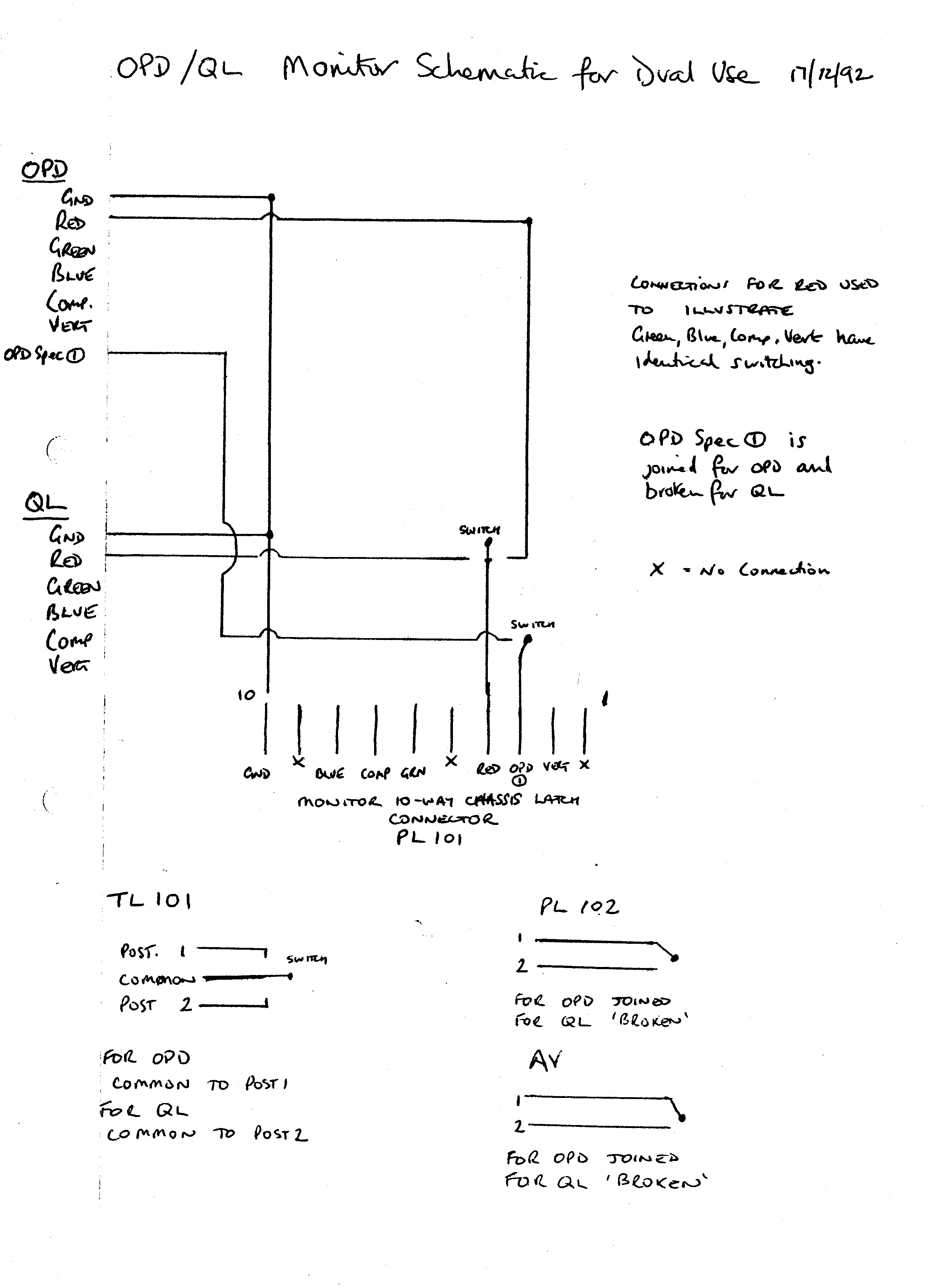

RalfR wrote:
Chr$ wrote:But you could use the CUB with the OPD to test it out? That's 2 OPD's in Germany then at least, there can't be many.
When Tony Firshman has sent the OPD with a monitor to me, the monitor was totally destroyed, a slightly bad package. So I had to modify my CUB to test the OPD. All work as expected but I just used it for a few hours, then back in the cellar.
In retrospect it wasn't a good idea to modify the CUB.
From my quick research I think the Cub in a different case is one of the 2 options for the OPD.
I have modified my OPD Microvitec monitor to accept QL input and fitted a switch.
Although the concept is the opposite to your probem the details may help you restore the Cub you have.
OPD / QL Dual Use for Microvitec Monitor
Posts: 1259
Re: ICL OPD
Thank you. But I remember, I have made a few other changes to make the CUB work with the OPD. Unfortunately, I can't remember them.
So I have a CUB working with OPD but no longer for QL. What can I do?
