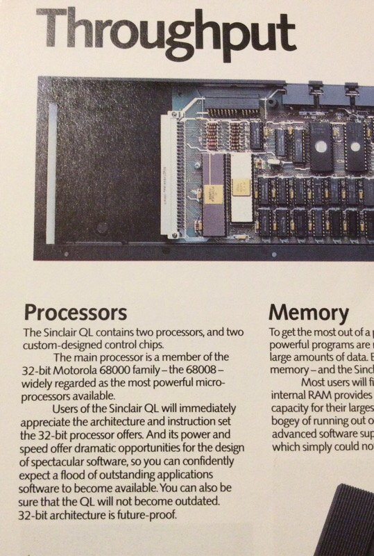

Well, Sinclair describes the QL as having two processors...
Two processors
Two processors
In specialist systems, there may not be a way for the main CPU system to be reprogrammed, and they cannot run any new user programs. But they are still considered to be or contain processors. E.g. in industrial systems you will find racks with processor cards with 68K CPUs running fixed application programs, the ‘user’ can only change the configuration by requesting new data ROMs from the manufacturer with the new requirements as supplied to the manufacturer. Only the data ROMs are changed. The ROM with the fixed application program is not disturbed or changed.
The main limitations are the technology of the day. Microcontrollers of today are rather more advanced compared to the 1980s. Today, a replacement for the IPC could well be designed to be reprogrammed by the main system CPU.
Hence, if more IO duties are devolved to microcontrollers or other MPUs , there is no reason why if required, they could do other things. Some arcade machines used multiple MPUs. Some had a MPU responsible for the sound system for example.
