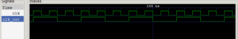

The idea of divide by `3' is to count positive also negative edge. This is a simulation of in
put and output wave.
Clock divide by Three
