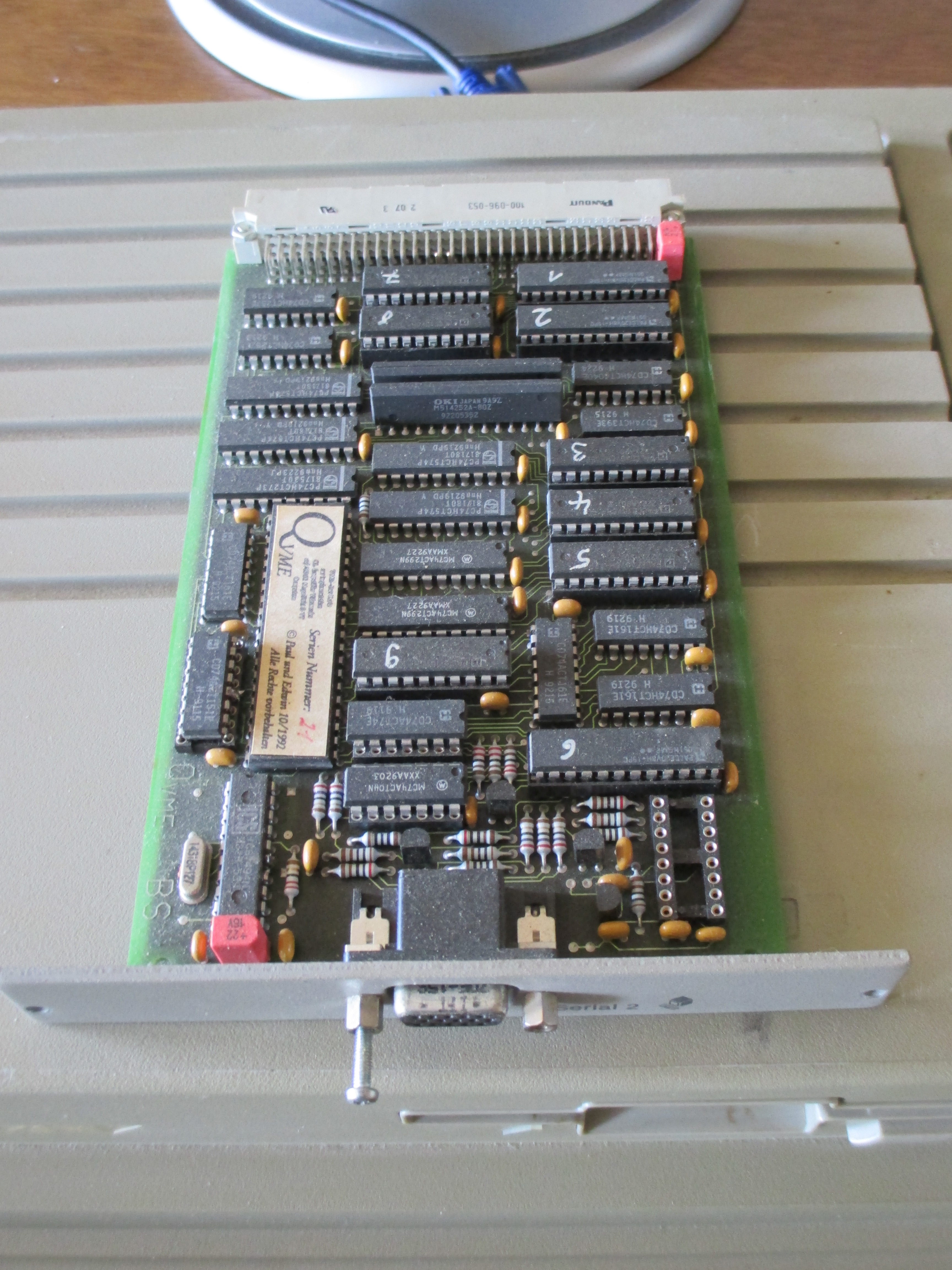

Re Graphics cards: There is at least one graphics card in existence for "QL" systems, namely QVME. Ok, it was designed for the Atari QL emulator, but the drivers are written by Tony Tebby. It was/is and excellent piece of kit; well-built and flexible. Is there anything there that could be copied or emulated, or somehow be of some use towards a hardware "QL" graphics card? Just my penny's worth..

It uses the Atari VME bus and is probably limited to mode 4. So when it comes to re-using existing hardware, Aurora graphics seems a better starting point.
Posts: 3198
Re: Announcement - new QL Interface
Yep. QVME supports 4 colours only, but up to a resolution of 1280x900

Its sooo long ago now, but I think the mode 4 limitation was because there was no GD2 at the time. The hardware was capable though, as Tony's Atari drivers could display the full Atari colours at high resolution. Another name for Atari's VME bus was Euro Expansion connector IIRC, so it wasnt some propriety bus. Anyway, you know best :) I only mentioned it because it is such a rare beast that many people may have been unaware of its existence:
QVME
QVME

I have one in my MegaST 4 via the MegaBus and an adaptor, which I have got from Edwin. Plus a WireWrap DIN socket, which stuck in the adaptor. Very clumsy but it works.

BTW: As far as Jochen concerned (after a discussion with Edwin Holtmann a long time ago): There is no way to make QVME able to display more than four colours, because "the logic chips are not able to handle the amount of data from GD2".
Whatever this means, it means, that noone there has ever thought to bring more colours to it or leave a way open to enhance it. But I know from an old TT whitepaper for SMS, that he had more colours in his design for future upgrades, which he releases, albeit a few years later. And this design was printed long before QVME appeared.
Originally, it was planned to use the STE/TT native colour scheme to run SMSQ(/E) without any display card (in fact QVME is not an Emulator, it is a display card), but that path was abandonned, as we all know.
So they should have known better.

Ralf R. wrote:There is no way to make QVME able to display more than four colours, because "the logic chips are not able to handle the amount of data from GD2".
In any case, with a 1280x900 resolution you can make many stipples variants!
