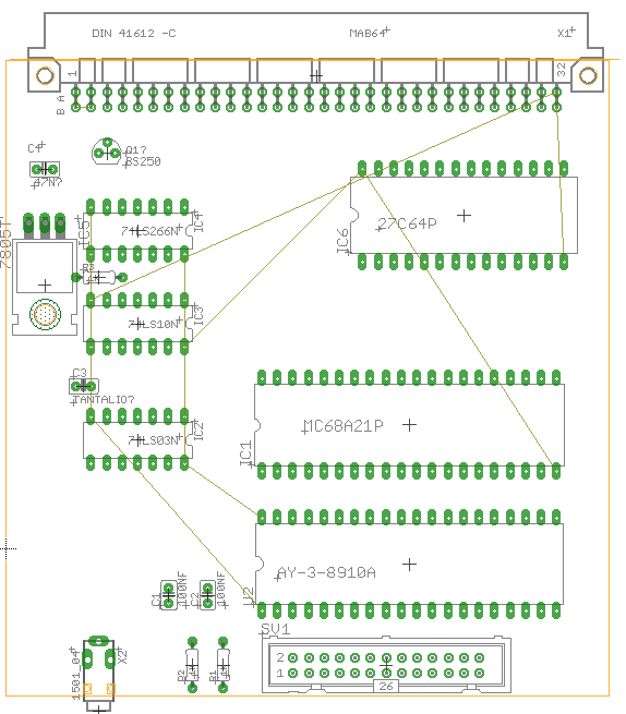

so i make a simulation for the q sound q print PCB.... i can se all the joints at pcb on botom...
but i dont know some connections on top.....its hidden by the chips......
OR the values of the tantalioum?? cap transistor?? maybe is a bs250 by guess....or the small cap near to the 7805
has any one the schematics? i will be glad to re design the qprint-qsound

Sorry, but why bother? There is no software with which the board needs to be compatible with and any newly built solution should feature at least a real crystal for AY clock and two AY chips IMHO.

for historical reasons i think its worth to make the schematic for archive...ho knows some one on the future say aok nice .....

Here's my take on it, if it's any helpDerek_Stewart wrote:I only contentplated this, mainly to repair my Qsound board.mk79 wrote:Sorry, but why bother? There is no software with which the board needs to be compatible with and any newly built solution should feature at least a real crystal for AY clock and two AY chips IMHO.
I have part done a Qsound Schematic, but I need my Board back to check the exact circuit routing.
I was going to alter the driver code to integrate into the QL sound system by gaving a more expansive BEEP command.
EDIT: see update
