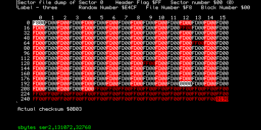

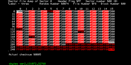

I am still toying with maps, I have a new interesting observation.
This is the map of my Cart labeled 'three' formated in drive 2:
Format gives 210/212
Stat gives 208/210 This is the map of my Cart labeled 'three' formated in drive 1:
Format gives 212/216
Stat gives 210/212 (1) It seems drive 2 format always misses 4 sectors at the loop end?
(2) Why do $FF00 sectors randomly appear inside the map, as I would expect them at the loop end only?
Tomas

- Posts: 1001
Re: MDV Low Level Routines
Working for memory, So I might have this wrong.
The format routine does two writes to each sector, each time with different bit patterns. ($AA55 and $55AA ring a bell)
If the sector fails on the first test, then it is flagged $FF, and if it fails on the second test, then it's flagged $FE
If you look at the data stored in the 'bad sectors' you should see the test patterns used.
One Microdrive unit formatting the same cartridge to different numbers of sectors than another Microdrive unit is common, I don't know exactly why. Motor speed? Manufacturing tolerances?
Back in the 80's, some people recommended formatting cartridges several times to find the highest of sectors you could get out of them. But this could cause problems if you had a suspect sector which just managed to pass the format routine, only to start playing up at a later date.
Martin Head
