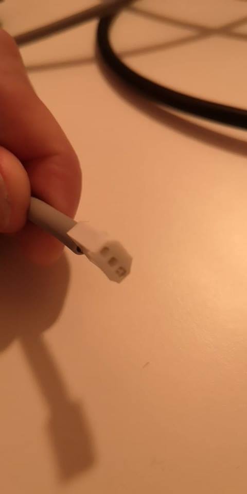

THE PROBLEM ITS ON THE FEMALE CONECTOR OF THE PSU.... CAN WE FIND THE 3D PRINT???

nikosdoykas wrote:CAN WE FIND THE 3D PRINT???
Try to ask dex, who prepared some 3D prints for the connector. Please read his posts in the previous pages (page 5)

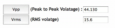

tofro wrote:(With 44V Vpp, you're also getting close to the maximum voltage of the input capacitors, which is 25Volts, so I'd rather stay beyond 20V (with "close", here I don't mean "dangerously close", but rather "long-term inappropriately close").
The original QL PSU is rated 15,6V AC
so, the 44Vpp max voltage is exceeded... Sorry, I must have misunderstood something crucial, but what?

Cristian wrote:Try to ask dex, who prepared some 3D prints for the connector. Please read his posts in the previous pages (page 5)
Martin J Dean has a post on FB, in group "Sinclair QL For Everyone" , describing his PSU replacement.
For the power connector he used a molex connector from the link below and cut it into shape.
https://ro.mouser.com/ProductDetail/Mol ... OEo_lKCzA8
Link to the FB post (Martin's description is in the comments): https://www.facebook.com/groups/3069939 ... 164192075/
