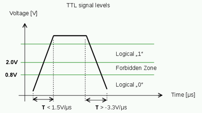

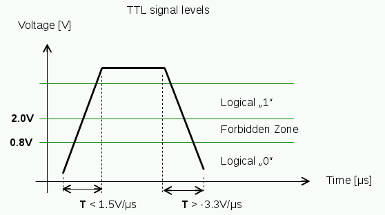

As I understand it, writing involves the ULA 'switching' its inputs to outputs and driving the same (stereo) pair of coils with the 50/100KHz signals.
Yes, I agree ZX8302 ULA does FM coding / decoding, while MD ULA does FM amplification and TTL hysteresis correction when reading, in my opinion. As I think ZX8302 needs TTL signal levels to safely trigger transition states, you describe during read, while signal transitions should not also be slower.
TTL signals
TTL signals
When looking at `waveforms' in SM, I can see 2V and 1V in samples, which exactly hits TTL forbidden zone. That possibly means I do not understand it.

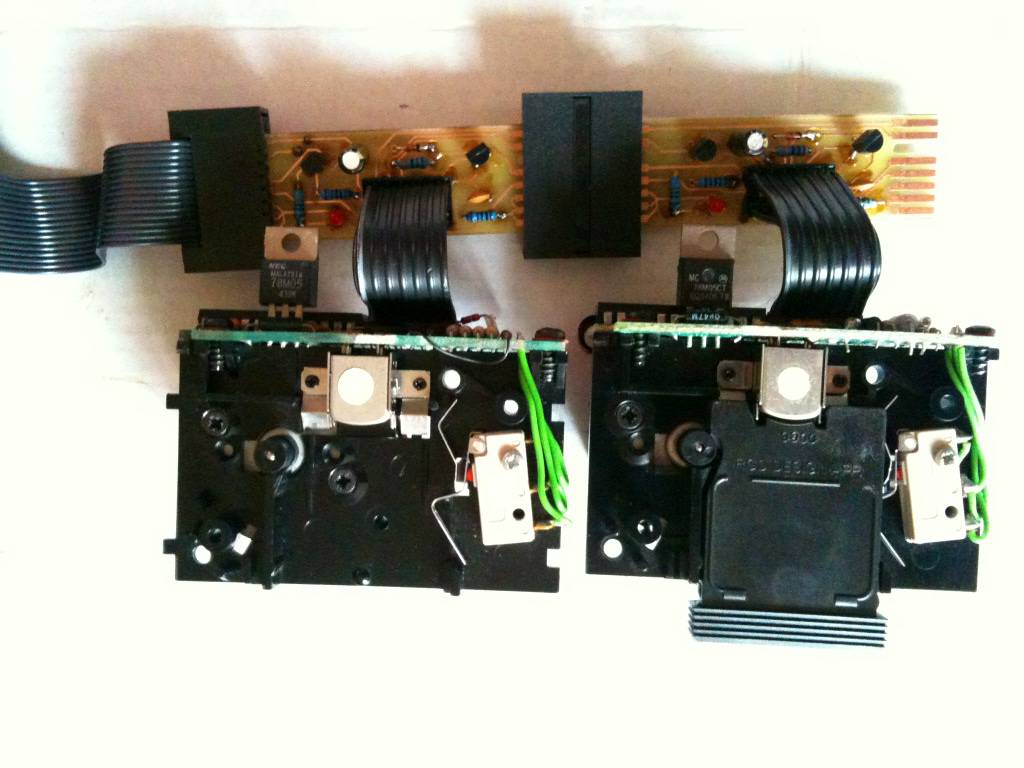

Just mounted the good R/W head to MD Iss#5 unit here. What you see in the picture are two MD units connected in a chain, MDV3_ is Iss#6, and MDV4_ is Iss#5.
Two drives connected in a chain
Now their speed is indicated by a simple program.
Iss#5 has mandatory mod applied.
Speed for two drives
EDIT, now I have just freshly formated a cart in Iss#5, and I am getting 7,25 secs. While other reference cartridge indicate 7secs. The accuracy of the tool is 0.25secs.

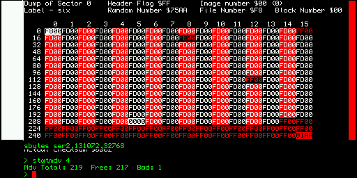

The tape map in MDV4_ Iss#5 after format of a used cart looks like this.
MDV4_ map after FORMAT
EDIT, formatting further gives 224/227 total, on overage Iss#5 seems a good performer, but not as star a performer as Cristian or Rich reports here.

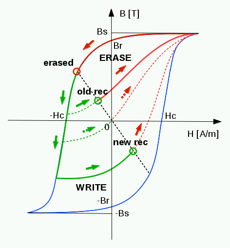

I managed to draw a magnetics curve, after quite a few emails exchanged with Louise, he has patiently guided me through it.
It shows an old MD tape record erased by a direct current, and a new record made with direct current premagnetics, that is a transition from one magnetic state to another.
Each writing to MD tape, begins with erasing record in both tracks, and then a new record is made either with (+) or (-) intensity per track. That should very roughly correspond to earlier picture showing `erase / write polarity on tape'.
